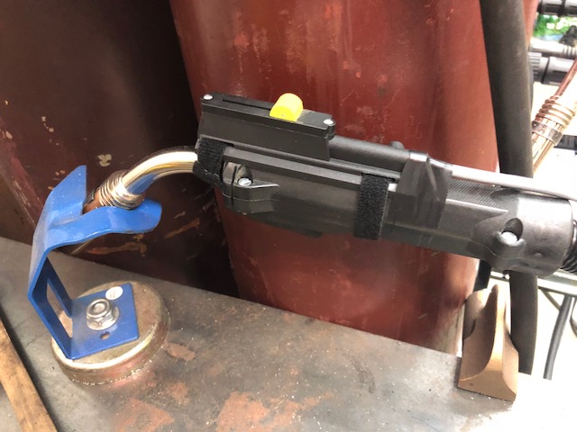

Finally got around to setting up 92/8 Ar/CO2 (even though I didn't really need it given that this baby goes up to ~40V), and it made dialing in things easy. Playing around with full manual double-pulse on 1/4" steel. Just like TIG pulse, lots of control to be had in the arc characteristics.
Slight push angle. No weaving, no patterns. Just pull trigger and move, with slight pause on pulse peak. Full manual control of pulse parameters:
Pulse frequency (Hz, PPS)
Duty Cycle (%)
Motor Percent (equivalent to "% base current" in TIG Pulse).
And a different run with slightly different settings.
Man this spray transfer stuff is HOT!
