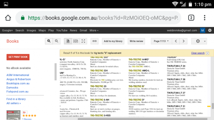

I came across some TIG rod tagged TIG-TECTIC B I looked on the Castolin Eutectic website and could not find it. The tube it was in was quite old looking, does anyone recognize this TIG wire and know anything about it?
If it's very old, they may have retired that specific name, but as you found out, the group name is still in use. Anything from Castolin is likely to be great. Maybe a direct email to them may help follow the succession. It may even be a special alloy for military use, they persist on using special numbers that don't apply in the real world.
Here is a little thing. 18-8 stainless
