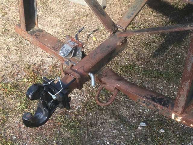

First a picture of the damage:
Broken hitch
Broken hitch
The first thing I did was cut off all the bent metal, crappy welds, and basically anything that was not needed on the hitch.

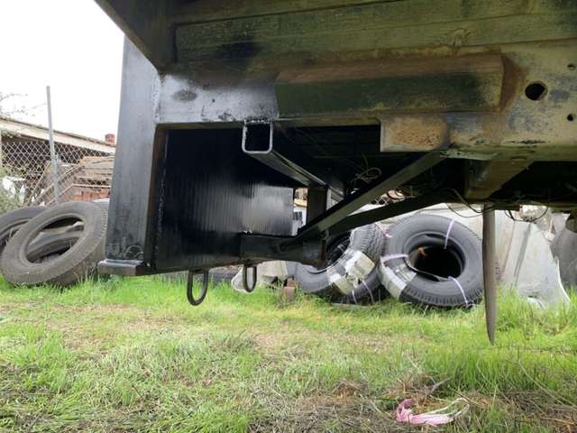

I then proceeded to weld a 1/2" thick plate to the bottom of the rear extensions.
Frame fix
Frame fix

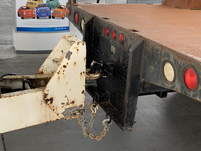

Now, at this point I started to realize I lack in some fabrication skills, because I should have used either angle or tube as it is much stronger, and I start to question my skills. I'm fine swallowing my pride, especially when I know I may be in over my head...so at this point I take the truck and talk to several welders and ask what they would do to fix it. During this time I welded the tube back on the crossmember I welded on, and welded a couple braces using tube...but still wasn't feeling the warm fuzzies on this projects...so I find a guy who for the first time doesn't say, "scrap it all, I'll weld you a hitch for $2k". Rather this guy says, "I can work with that, brace it from the back, and weld on diamond plate behind the frame, it will be rock solid. The shop was San Martin Specialty Shop, the owner is Jeff Moore. Can't say enough good stuff about this shop. He was able to salvage the work I did, so it makes me feel pretty good knowing I was able to do quite a bit of the work. This is where we got to.
Rear support for hitch
This was not exactly what me and him had discussed, as I wanted the pintle hook mounted up directly between the frame extensions, but we were almost there. I left the truck with him and he welded another support behind the plate and attached the pintle hook to it (rated at 30,000 lbs). The reason I didn't want to use the receiver tube is that the tube is only rated for 15,000 lbs, so that would be my weak point.
Near completion
Near completion
This is when he welded the cross brace between the frame extensions, move the pintle hook up. All the trailer wiring is working 100% correctly, including the new brake controller I installed, and brakes are tested working. Jeff Moore also added a fused wire back to the trailer so I could charge the battery. He recommended not to charge while operating the winch, which is fine with me.

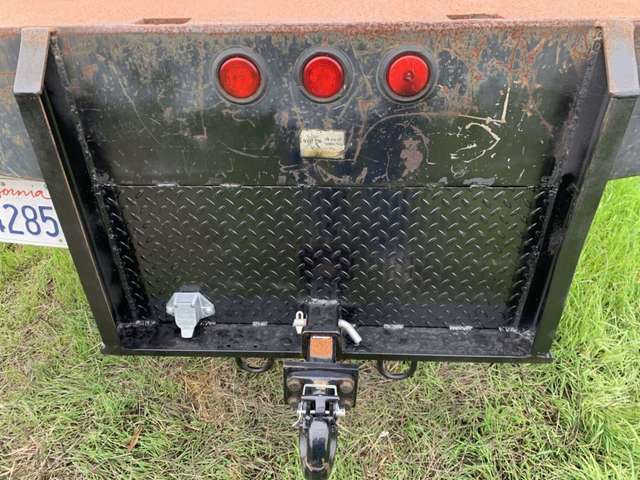

Completed hitch, wiring working correctly, brake controller hooked up to trailer.
