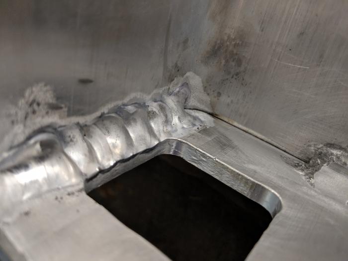

So I have gone back to a ceramic cup, now using a Thoriated red tungsten, am operating between 200-230 amps and and floating between a balance of 65-70. And I'm still getting splatter. I have cleaned the material religiously. I'm using a stainless steel wire brush only used for aluminum in one direction and wiping down with acetone. here are some pics. The last pic shows the passable welds I was getting before i started getting this splatter.

Based solely on what I think I see, you are way to hot. Those black spots in the weld are probably from your tungsten if you did get everything else as clean as you say. At the end it almost looks like you stuck the tungsten into the weld puddle. That tungsten burn down is what I'm looking at mostly.

If he's using RED as a tungsten on AC at 200+ amps, I would not be surprised his tungsten looks like that. Also, his BALANCE is set pretty high on the cleaning side, which is very hard on the tungsten too.sschefer wrote:At the end it almost looks like you stuck the tungsten into the weld puddle. That tungsten burn down is what I'm looking at mostly.
I'd switch back to your GREEN if you don't have BLUE, set the balance to 75-80, a blunt grind (think 20* taper) and keep the stick out pretty short. The ceramic cup in your picture looks to be pretty small. Set your argon flow to 2X the cup size (ie, #5 cup, 10CFH).
If your machine works for a short bit producing a decent bead, then starts crapping all over itself and producing those welds, you have a machine problem, not a gas problem.

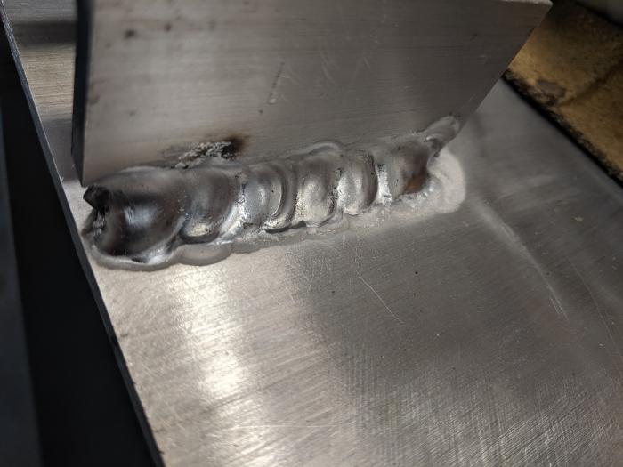

So the issue seems to be corrected. I switched back to pure tungsten and balled the tip. Raised the balance to 75% and lowered the amperage to around 170. Picture below. Not a pretty weld but controlled and no contamination.

You need to bump your amps back up. The toes of that weld are not fully wetted in. I'd bet you can hand bend that vertical straight off due to a lack of penetration. And if you cut and etch that fillet, you'll see no penetration.
With those type of welds, you really got to put the tungsten into the seam, get your puddle wet top and bottom, add some filler, then make sure you aren't leaving a rabbit hole at the root of the fillet. Add filler, push the puddle forward, as it "keyholes" back up, add filler, then push forward. This will help drive the filler into the root. That and amps.

amps to cold.
the other problems that arises is travel speed slows and the part over heats rather quickly. hot and fast is better
i would guess the issue was probably blowing the tip off the tungsten at the higher amps.
if the pure balls up to much, then change to a better tungsten.
i can run 180 amps 1/8 2% lanthinated tungsten without it balling. blunt grind 70% balance.
