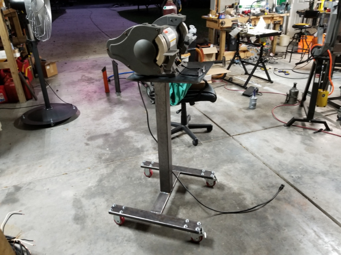

I just made myself a much-needed bench grinder pedestal. On a forum member's recommendation, I used Fireball Tool squares because I don't have much of a table. They worked very well. Not a panacea, but I would feel comfortable building a welding table base with them, and that's something I'm hoping to do.
Anyway, the bottom of the pedestal base came out very flat because I used the squares, but I was not able to clamp the base down when I welded the column to it. I didn't take my time, so the base bowed a little. I wasn't worried, because I figured I could use heat to straighten it.
I have a gas rig, but I still don't have gas because I'm waiting for a good deal on tanks. It occurred to me that TIG was pretty similar to acetylene, so I decided to try to do "acetylene straightening" with a TIG torch and no filler. It works great.
Is this a popular practice? I looked around and saw that other people do it. I'm amazed that I never heard of it until I thought of doing it on my own.
Really happy with the squares and TIG straightening. This pedestal came out great. You can jump on it and ride it around without flexing anything, and the base is flat and square.

I don't know if I would say I did fusion welds. I held the torch close to the metal until it started to liquefy, and then I moved on. I didn't try to join anything. There was no filler rod. I was working in an area where there were no welds.
I used a straightedge to see where the bends were, and I applied heat on the opposite side of the tube.

This will give you an idea of what I did.
Also, an obligatory photo of my project.

This is defined as a "fusion weld". And his point about mild carbon steel is exactly correct. These welds will not be as strong and prone to cracking on the edges.Chips O'Toole wrote:I don't know if I would say I did fusion welds. I held the torch close to the metal until it started to liquefy, and then I moved on. I didn't try to join anything. There was no filler rod. I was working in an area where there were no welds.
If that happens, a little V groove grind down the middle, and re-weld them with filler wire.

From the pics, it doesn't appear that a little bow would be an issue. If it 'wobbles', shim the high wheels.
FWIW, I would (actually did) bolt plates on the front H's "aiches!" using the screws holding the wheels on, then weld a piece of pipe/square tube across to them. You can put your foot on it to stabilize the unit while in use.

The bowing didn't make any difference in the pedestal's performance. I just wanted to learn about straightening.
When he talks about "no filler," I think Chips is referring to what he did to "flame straighten" his assembly -- not to the actual welds joining separate pieces. In other words, he didn't add filler just as you wouldn't add filler if you did the flame straightening with an O/A torch.cj737 wrote:This is defined as a "fusion weld". And his point about mild carbon steel is exactly correct. These welds will not be as strong and prone to cracking on the edges.Chips O'Toole wrote:I don't know if I would say I did fusion welds. I held the torch close to the metal until it started to liquefy, and then I moved on. I didn't try to join anything. There was no filler rod. I was working in an area where there were no welds.

Chips, you don't need to actually liquefy the metal to flame-bend it...just get it hot enough to soften it temporarily ... orange or so ... and the cooler metal restraining it will force the heated metal to upset (thicken) and then when it cools down, it will shrink in length, causing it to bend.

I have 1) been burned by this phenomenon, when I didn't anticipate it. And 2) successfully used it to compensate the anticipated tube warpage that happened in the intended structure. In my case it was MIG, so I had to grind off the sacrificial compensation weld beads, but it worked out great and the tube structure came out almost perfectly aligned. Just plan on applying equal but opposite weld effected zones, in order to compensate. be as symmetric as you can.
