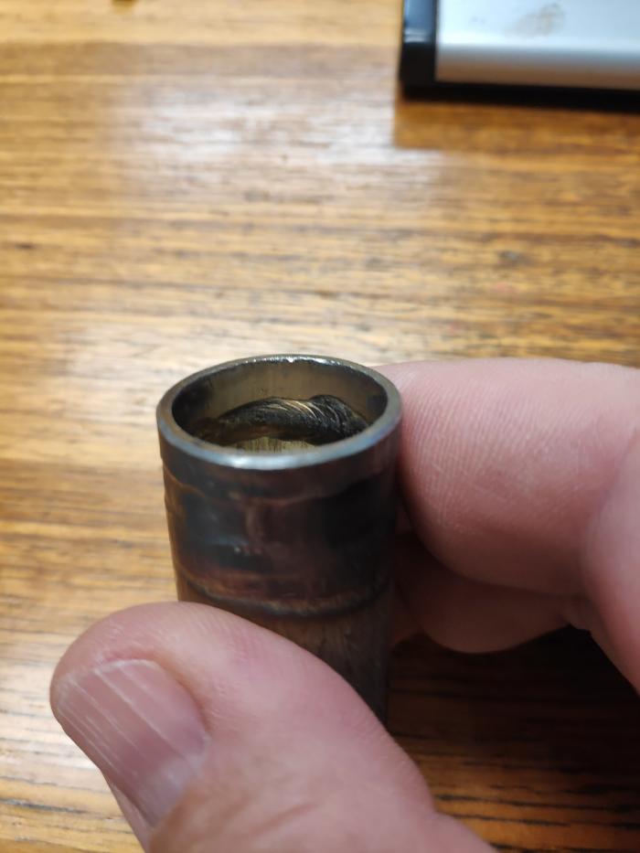

You can also purge with industrial dry nitrogen to keep the purge costs down. I've purged hundreds of welds with nitrogen that takes 150psi every day. Gives a slightly gold shiney but clean and hygienic finish. I wouldn't recommend it for nuclear or aerospace but for non-critical work it's fine if you have it on hand. For small jobs or critical, it's easier to just put a dual output regulator on your argon cylinder and purge that way.
- NP1.jpg (48.78 KiB) Viewed 1913 times
