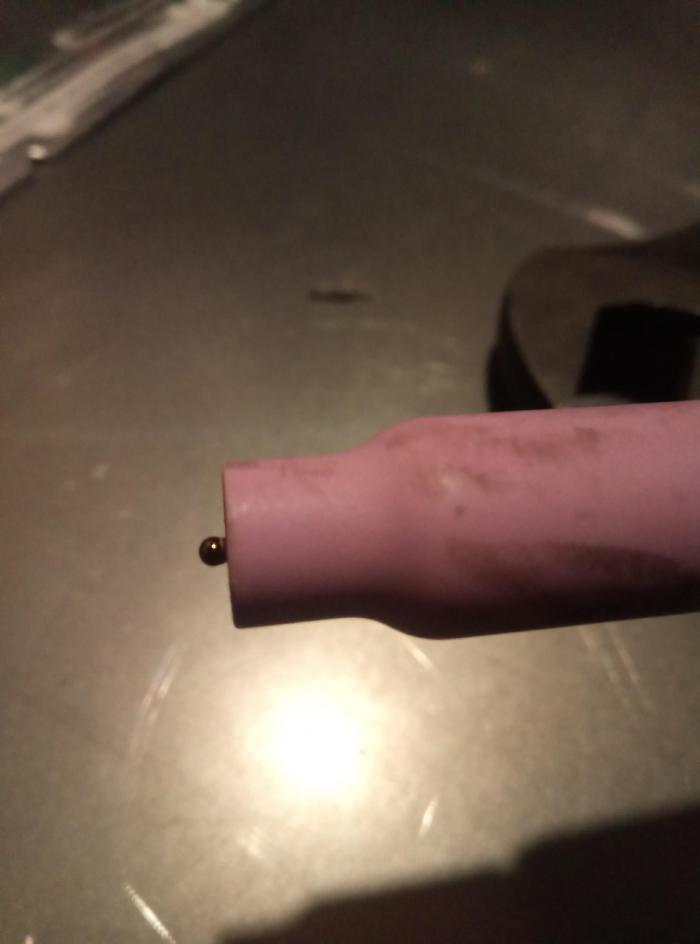

btw do you have pic of the tungsten. i wouldn't expect much balling at 80 amps.

yes i start with a sharpen electrode with blunt tip but as soon as the trouble start the tungsten ball up like if i have it on real high DCEP. the 120V input is one of the culprit i admit i didn't thought of playing with amperage ill try that next. right now i dont have access to 220v but i think the machine is suppose to handle AC 80 amp on 120v ( or maybe not ). thanks for the idea this is why im here.

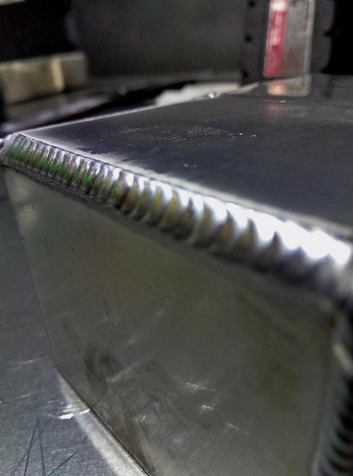

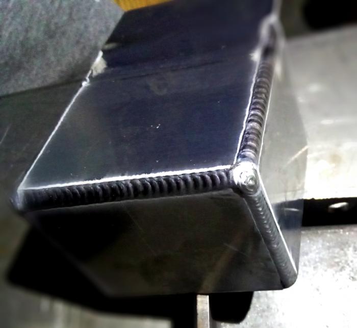

allright ,
so i was able to do more test on the machine , turn out im a complete goof ball ( as i was hoping ) . so the solution was a good clean tungsten , not too much cfh , enough post flow to keep your tungsten clean ( i mean keep your tungsten clean ) and enough amp to get a quick puddle. i didnt know how peculiar an AC arc was at lower amp , everytime i welded aluminium with other machine was 150 amp and up so i guess the higher amperage help clean up any mess that is on your tungsten. so i think the main mistake i did was not taking care enough of my tungsten and not running enough amp for the material thickness. so now machine is running awesome heres some pic i did today , im really stoked to be able to practice aluminium on 120v outlet. sorry about all this, i think a was too excited to get the machine running the first time and didnt take care about the basic stuff. thanks a lot all for the support !

He did say it was dirty tungsten, not in those words exactly, but that's what he said.Simclardy wrote:Nice weld. Still not sure why it was surging? Low amps? Dirty tungsten? Something's not adding up but all's well that ends well
