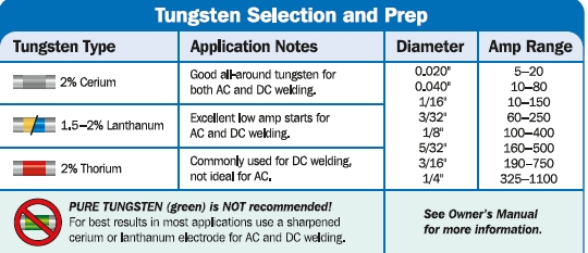

Do y'all match your tungsten size with the same filler rod size? Because I have 1/8 tungsten but I only have 3/32 filler. Is that fine or is it better to match the tungsten and filler rod size?
Location:Orlando FL
Tungsten size has no relationship to filler size, the tungsten diameter is determined by the amperage you'll be welding at. Even then many will weld with a 3/32" tungsten at say <50 amps with .035" fillerWildwelder96 wrote:Do y'all match your tungsten size with the same filler rod size? Because I have 1/8 tungsten but I only have 3/32 filler. Is that fine or is it better to match the tungsten and filler rod size?
Here is a chart showing amp range to tungsten dia.
- tungsten chart.jpg (71.16 KiB) Viewed 4200 times
