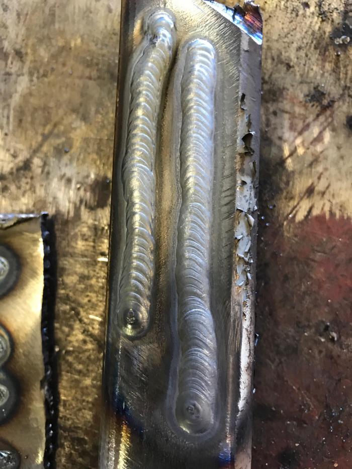

I just bought my first TIG machine a couple of weeks ago, that machine being the Primeweld 225. Since the very start, I have been getting welds that are just completely porous along with the nasty brown haze I have heard about before. It's been very frustrating as I have been changing every setting I can think of and nothing has made a difference. If anybody sees something in the photos that could point me in the right direction, it would be very much appreciated. My gut is telling me it's definitely a gas problem.
Material:
- various scrap pieces of mild steel
- cleaned and wiped down
- no filler was used in these welds, just trying to make it lay a nice bead
Machine Settings:
- always roughly 1 amp/.001", controlled with the pedal
- preflow: ~1 sec, postflow: ~6 sec
- no pulse
Torch:
- CK 17 with stubby #8 lens
- 2% lanthanated tungsten
Gas Settings:
- ~15 cfh of 100% Argon

Your settings sound ok.
1) Remove your cup, completely loosen up your back cap, and make sure the gas lens is threaded in securely before you insert your tungsten and tighten the back cap, that can lead to air being sucked in.
2) Make sure you're not sucking in air from any of the connections. You can use soapy water to see if bubbles form.
In short, air can cause burning and/or porosity.
I don't see anything wrong with your settings. The only other criteria is the actual metal you're welding and/or if it has any coating on it.
Sounds like you're down to clean metal and wiped it clean with acetone.
How far is your tungsten away from the work when you weld? What type of angle do you have the torch at and how fast are you feeding? Can you see your puddle form and do you see the puddle moving as you move your torch? You must as you have a bead.
Make sure the ground is securely clamped to your metal. Mystery metal could very well be the problem, that I don't know.
One other thing, is your machine set to DC?

Definitely contamination due to oxygen/air. Let's rule out your TIG torch first, as I/we have seen this to be the cause recently (myself included). Post a picture of the torch, and also disassembled so we can see what parts you used.
Try bumping your argon CFH up to 35 to see if the problem goes away. If it does, get a new flowmeter and run the argon at the normal flow rates.
A lot of the flowmeters coming out of China over the past few months have had major issues with their flow calibration being way off. The factory shipped them with an incorrect part, or something along those lines. Your issue may be related.

is the torch together properly? Remember we had one fella had the torch together upside down??
what is the stick out of the tungsten ? How far away from the base metal are we working?

Thanks all for the words of advice! It ended up being I believe something related to the insulator on the gas lens kit. I happened across a post by Oscar regarding the gas lenses potentially having a few issues. I swapped back to the standard consumables and all the problems vanished immediately. I'll have to look into getting a more reputable gas lens kit. A CK most likely to match the torch. Now I just need to improve the technique! Thank you all again for the feedback.
Any comments on what you're seeing here are more than welcome as well!

What type of gas lens kit were you using?jackd wrote:I'll have to look into getting a more reputable gas lens kit. A CK most likely to match the torch.
I primarily only use CK consumables and don't have any issues with them. I have the same welder, same torch, so was curious what doesn't work that you were using???

Amazon special. No stamping or anything I saw on the collet body. The screen itself was fairly clogged though too, and that definitely would have compounded the issue I was having. So, maybe if I were to either clean it or replace it (not sure on the standard procedure with that) things would improve.TraditionalToolworks wrote: What type of gas lens kit were you using?

Well, at least you figured it out, but you may have just had the wrong insulator on the torch, it needs to seat and seal to keep the gas in and not suck air. Who was the company you bought from on Amazon? Good to give people a heads up to avoid them if nothing else.jackd wrote:Amazon special. No stamping or anything I saw on the collet body. The screen itself was fairly clogged though too, and that definitely would have compounded the issue I was having. So, maybe if I were to either clean it or replace it (not sure on the standard procedure with that) things would improve.
