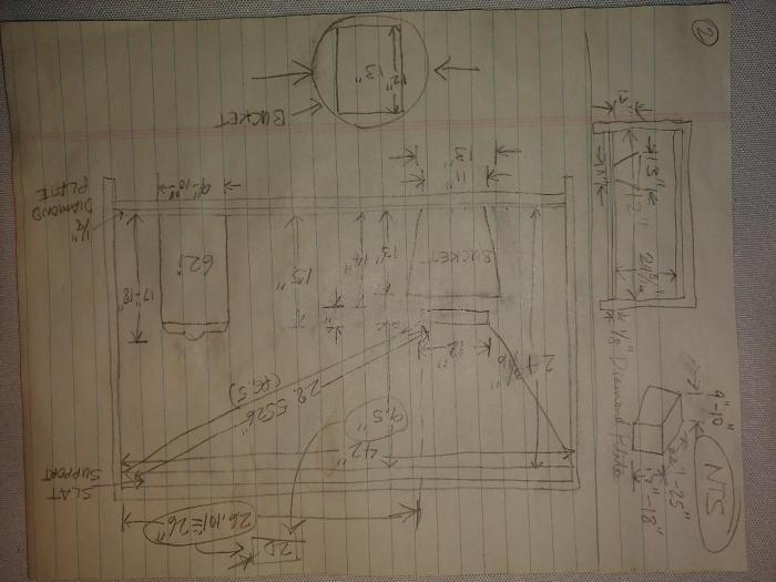

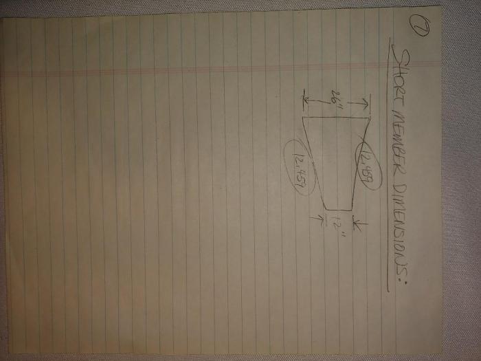

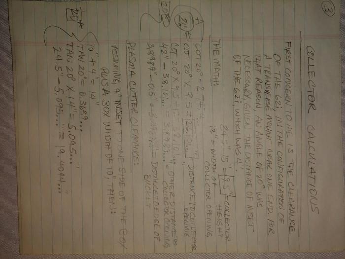

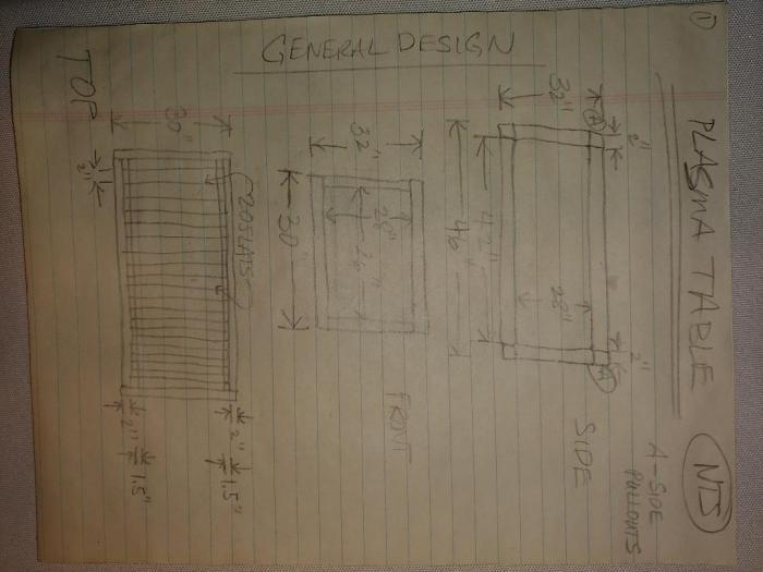

Then there was the table. Mine ended up being a combination of several tables that I saw pictures and/or video of; as I recall Jody built one at some point in the past as well. I watched his video, but that table was designed more for the school/teaching environment, so it was intended to have a fume extractor, etc. I won't have that in my workshop, again, considering the use case scenarios and frequency of operation. So a little more of a fundamental design was the way I elected to travel.
These were the plans that I drafted. Ignore the "62i" in these pictures, as I was still eyeing that box at the time I drew these.
- plans 1.jpg (37.7 KiB) Viewed 10639 times
- plans 2.jpg (42.79 KiB) Viewed 10639 times

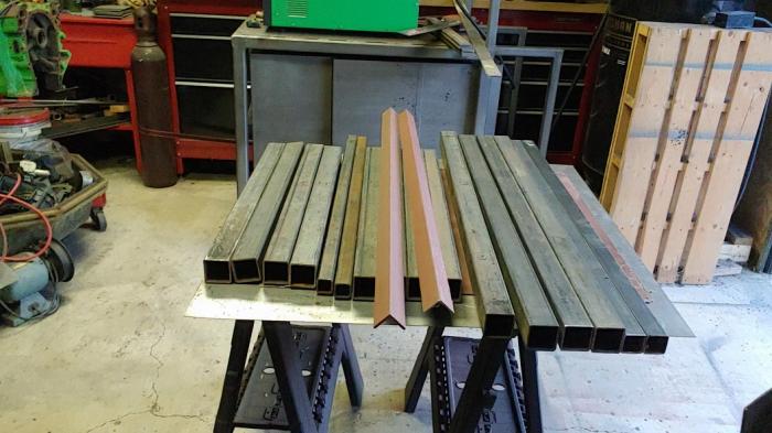

So I got to work last weekend or the one before that, don't remember. I began with the raw materials:
The tubing is 2" x 2" x 1/8", 1.5" x 1.5" x 3/16. Angle is 1.5" x 1.5" x 3/16". The slats are 2" x 1/8" flat bar.
- materials 1.jpg (50.68 KiB) Viewed 10637 times

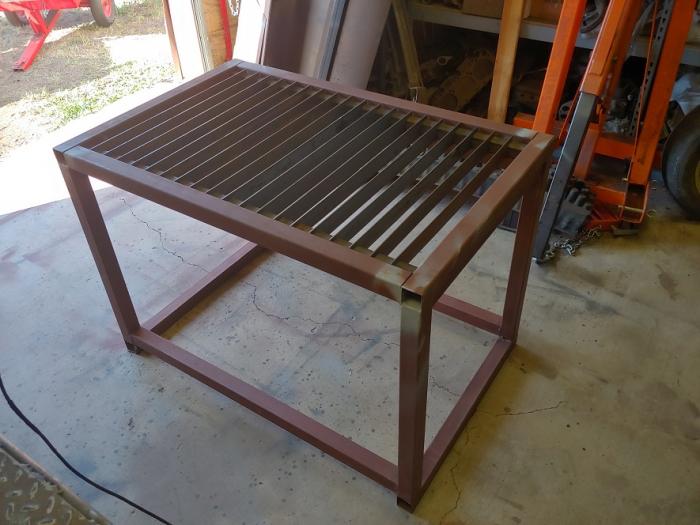

I chose to elevate the longitudinal crossmembers (lower) by the height of the tubing (2") purely as a "stylistic choice". From a practical perspective it would have been better to leave them in the same plane as the other lower crossmembers, as that would yield greater height to deal with the collector. However I went this route and chose to live with the slight difficulty that decision brought to the project.
This is where I left it this past Sunday:
I have the slats and the smaller tubing that supports them installed. The To-Do list as it stands at present:
1) Cut and install the collector
2) Cut and install the lower shelf (and its supports)
a) The supports will be made of whatever I have lying around
b) The shelf will be 1/8" diamond plate
3) Fabricate and install hooks on which I'll store the torch cable
4) Install bucket and bucket holder (which will be 1/2" flat bar)
5) Decide whether or not to even bother painting it or leaving it in rusty metal primer
6) Cut some 2" x 2" flat bar to plug over the tubing holes on the bottom
7) Install casters or other means of mobility
8) Consider installing a handle
9) Fabricate and install table extensions (which will be placed in the tubing holes on the top, increasing the table's width)
So that's a fair chunk of stuff that remains outstanding, but mostly of the "little tasks" variety, so it should go quickly.

If you don't plan on CNC then your table looks like it will work fine. Are those slats replaceable? I hear they will get chewed up fairly quickly. Yeah, I get plenty of computer stuff at work also...

Yes, they are removable. They merely rest in their respective slots and on top of the 1.5" x 1.5" tubing. And yes, they will become shadows of their former selves, but that is normal. I have 4 extras on standby...TraditionalToolworks wrote:If you don't plan on CNC then your table looks like it will work fine. Are those slats replaceable? I hear they will get chewed up fairly quickly.
