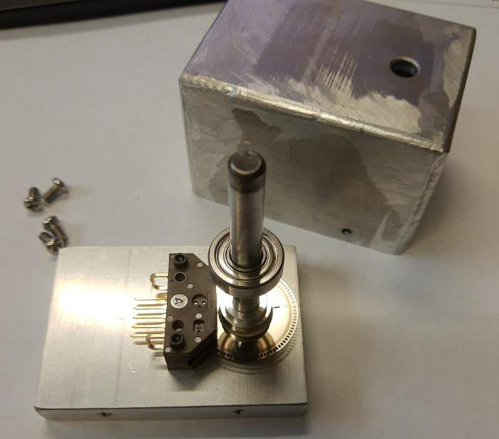

How about I add a little context:
Here's an optical encoder. For the record, I use these components in devices I build.
Encoder datasheet: https://docs.broadcom.com/docs/AV02-1867EN
Codewheel datasheet: https://docs.broadcom.com/doc/AV02-1450EN
If you read those datasheets, those encoders will operate at 30,000 RPMs 2048 pulse per rev. (In fact, other higher res models will do the same rpms @ 32768ppr... That's over a million individual transitions per second, even on the slow one.
Side note: The waveform output from these things on a scope is nothing short of beautiful...
So, these folks can make a sensor that will see an infinitesimal amount of light, looking through microscopic holes in a metal codewheel, and not miss one (with two different sensors with positions offset from each other, neither missing...), but folks making welding helmet shades can't reliably tell when the sun is out or not...
