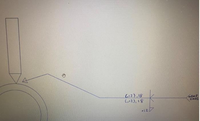

Hello All! New to the forum here. Been welding TIG on Stainless and Ti for 8 years mostly gauge material and some structurals with MIG as jobs come through. Looking for some help with weld specifications and call outs on a job I'm quoting. First off, Where can I find details on welding in accordance with 01417 SD-X12142 Class 3? Weld Metal called out is E-100. Not sure if this is the same as Lincoln Electric and Washington Alloys ER100s-1 which falls under the same spec (AWS 5.28) as the called out E-100 on the prints. I can not find a filler called "E-100".
Next Question is about the call outs on the drawing attached. So in my understanding it calls out bevel both sides and weld arrow side with .12 leg. wrap both sides of the weld. Not sure if my interpretation is correct as I don't see a field weld call out and not sure why it would call out bevel both sides and only weld one side. Any help would be greatly appreciated.

Poland308 wrote:Looks like they mean welded all the way around, even on the ends. Must be pretty thin material. I don’t know about the material spec.
The plate will be .380 and the tube will be 5/16" with flats milled in it.

The way I read it:
Other side, .12 bevel of part, .18 bevel weld
Arrow side, .12 bevel of part, .18 bevel weld, combination weld .12 Fillet weld.
Wrap ends.
Take it with a grain of salt. I'm not a welding engineer but have designed weldments in the past.
Also any good engineer will be glad to explain or help with a drawing.
From ASW Welding Handbook Vol 1
Wrap ends.

After further research, This actually makes sense. Going to confirm with my customer to see if they can get in touch with quality control for these parts and confirm exactly what they will be measuring for. Thanks!manac wrote:The way I read it:
Wrap ends.
