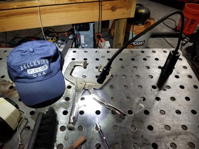

I have tried to get decent welding lights for years, and as technology has moved forward, I have gotten closer and closer to getting what I want.
For a few years, I've been using a gooseneck LED lamp with a magnetic base. It's pretty good, but it's a pain to move it around because of the cord, it's not as bright as I would like, and you can't put a bright light on a small area.
I just picked up something way better. A grill light. This thing has a magnetic base that holds three AA batteries or a rechargeable with an adapter. It has a neck around a foot and a half long. It has an adjustment that lets you concentrate all the light on a very small area. No more wrestling with a cord.
Has anyone else here tried one? It looks like engineering has finally produced the perfect small welding light.
02 14 21 new magnetic welding light small.jpg (66.43 KiB) Viewed 5919 times

I don't know if this is the best deal or even the best light, but here is a link.
https://www.amazon.com/gp/product/B07L6 ... UTF8&psc=1
I find that technology gets way ahead of me. My old light still seems high-tech to me. If I hadn't Googled around, I would never have known about this new one.
I haven't looked into getting an adaptor for a rechargeable battery yet, but I am told it can be done.
EDIT: a guy posting on Amazon says a 18650 battery will fit if you wrap it in something to fill the extra space. I already have a bunch of 18650's for flashlights, and I have a smart charger that costs about $50.
Okay, it gets even better. Here is a link to some battery adaptors.
https://www.amazon.com/LampVPath-Protec ... ics&sr=1-2

I started using it, and it's fantastic. It sticks to the table well, and if you have a project that stands up, you can attach the light to the project itself when welding joints higher up.
