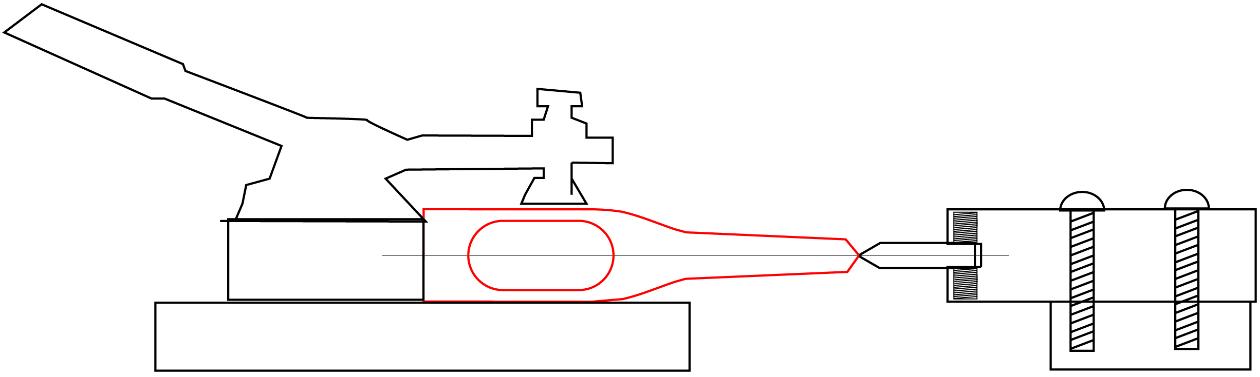

It's for an axe head. To date I have been making my axe heads from solid 4140/42, but mostly from 4340 billets. Rather than do the common practice of forge welding a high carbon bit to mild steel, I thought to try welding a 1/4" x 1-1/4" 5160 piece to the edge of a piece of mild steel.
The axe head would be formed mostly to final shape. After welding, grind to final shape and heat treat.
I drew a sketch of a fixture/jig to hold the axe head and the 5160 in line and in place as they are welded.

As I have not really attempted welding sprinģs, mainly cause I have not needed to. But that weld procedure I mentioned should work as good as any. Q and T plate may work better but as you said its not economical there....or anywhere these days.
I would do that with 7016 stick or dualshield 81ni wire 25 /75 gas. 71 would go ok but 81 is better for this and same price.
Handy tips, peen each run with needle scaler while its hot. Dont weld it while its 200C or above but dont let it cool right down below 150C. I.e dont weld while its near glowing is all you need to worry about in practise.
Weld one side 2 runs flip over and back gouge, grind into weld on other side to make solid metal when you weld.
2 runs then weld out however you want if its under 40mm total. Keep in mind if its over 40mm thick than a few runs or so then flip over to other side just to stop it pulling too much one way. You may already know this but it does rate a mention.
Run on and off tabs, will stop cold starts and rough stops. Just a 5mm bit of plate at each end of weld that gets cut off after. Just dont let it rapidly cool or you will get grain growth and brittleness, you may get some anyway, but post heat and slow cool will help minimise.
I hope it helps and let us know how it goes with the heat treat after.
