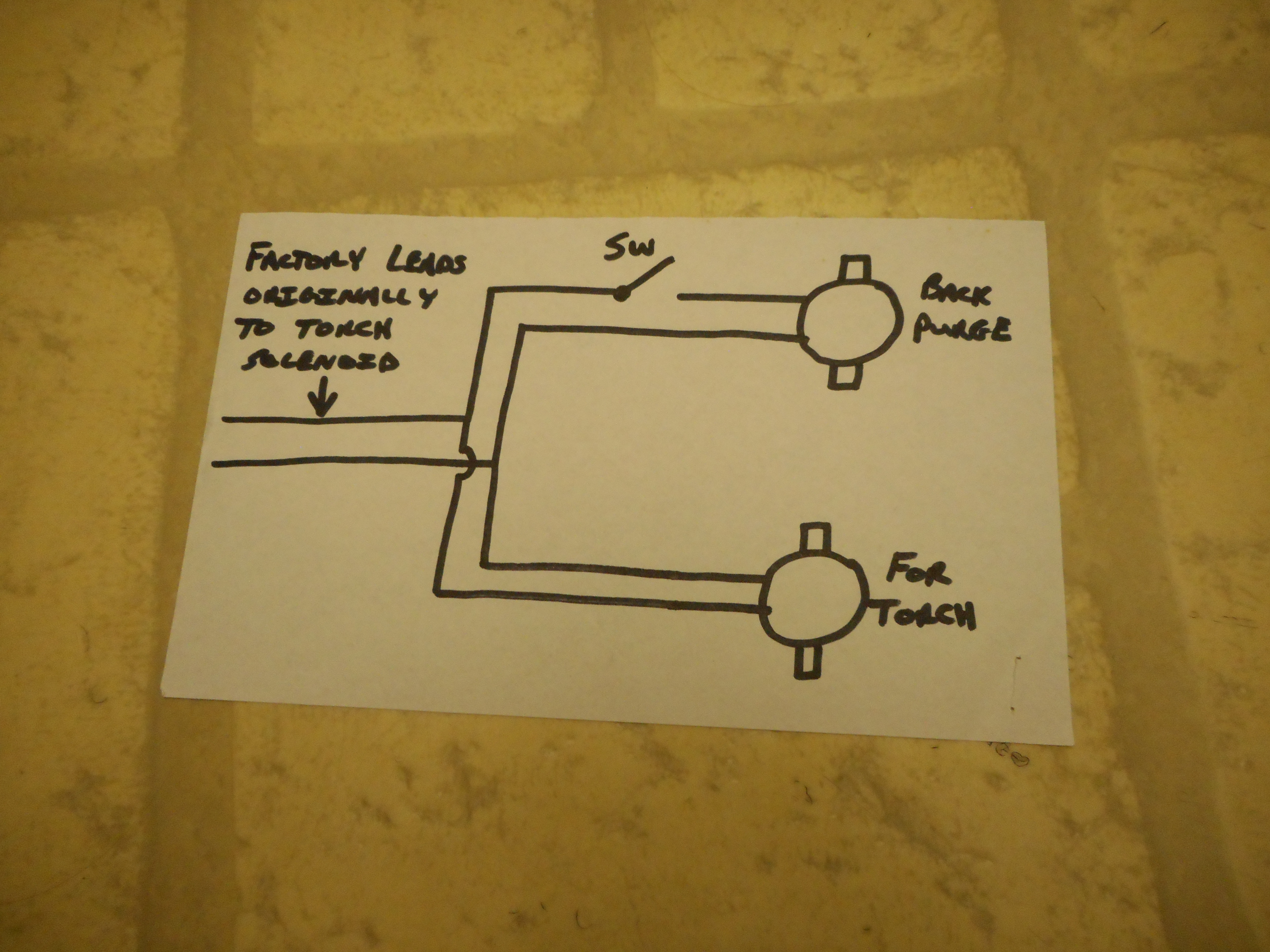

1) Can I just pull power from the first solenoid, basically teeing off it?
2) If not, what are my options?
3) Should they be wired in series or parallel?
4) What voltage valve do I need? (I think they are 24VDC, but not 100% certain)

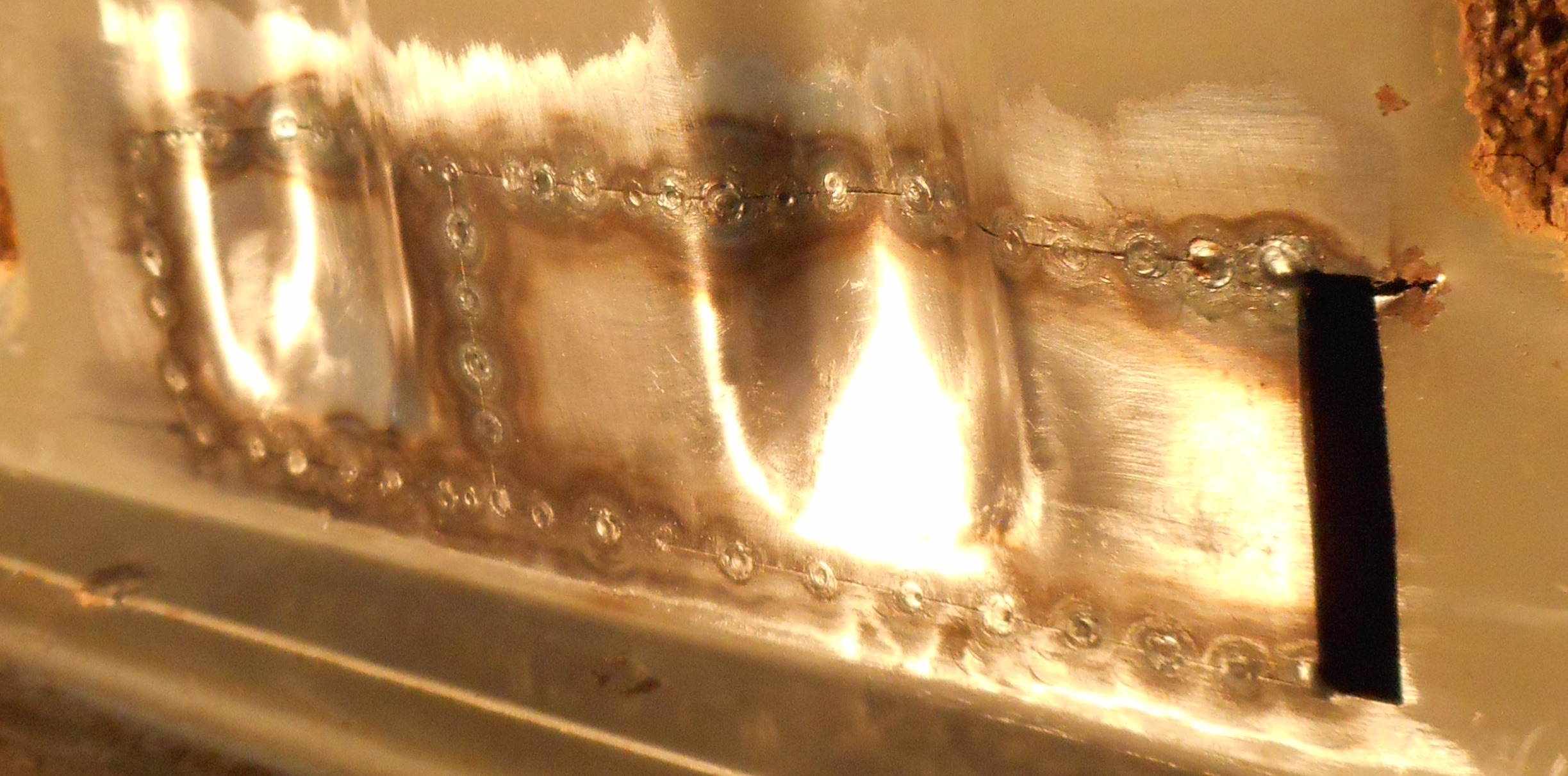

I've tried just about everything I can think of (pulse, super low amps, super fast travel speed) to prevent scale from forming on the backside and have come to the conclusion that it's impossible, at least for me, to do w/o a backpurge on such thin material.

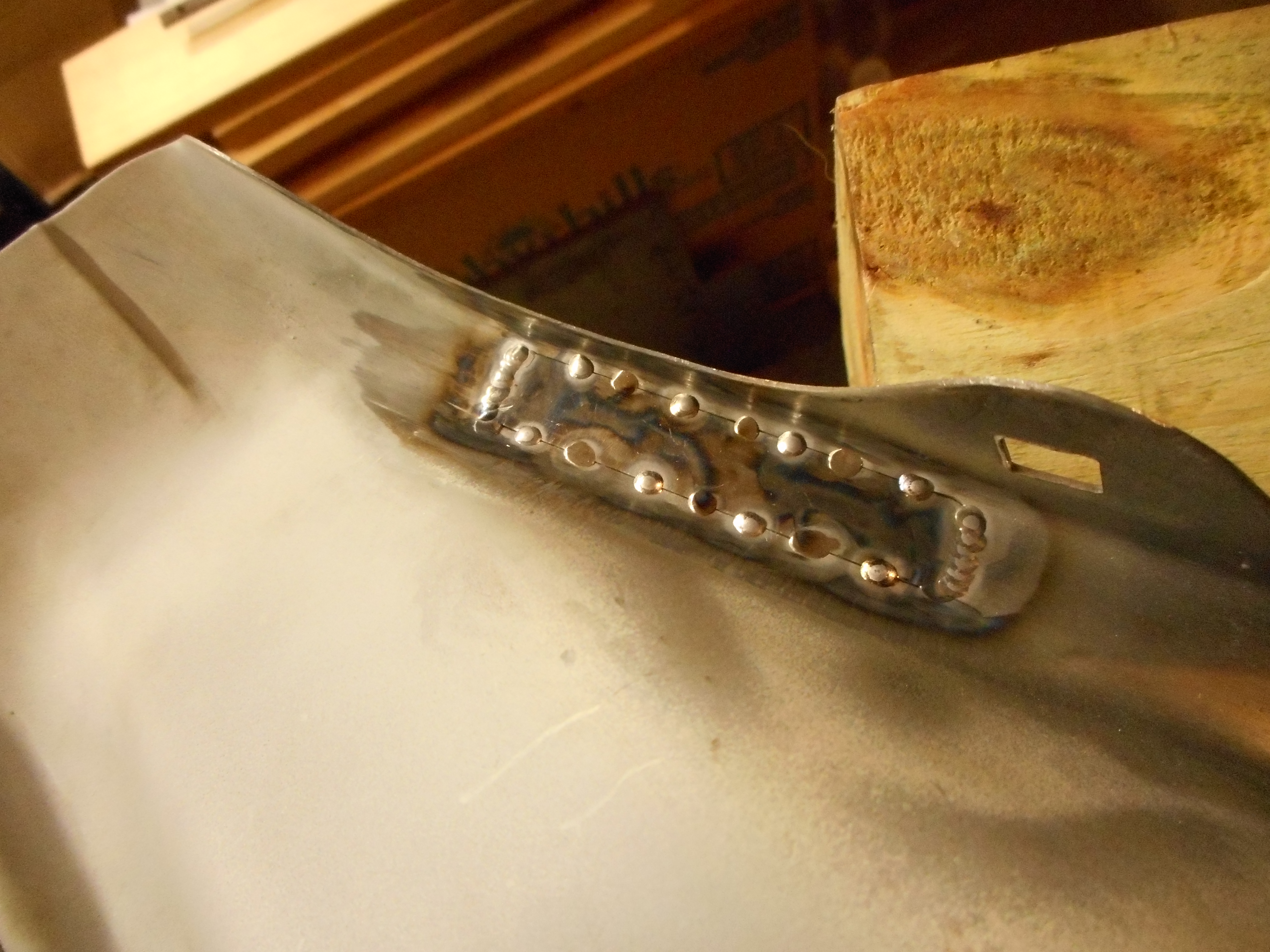

- Backside, w/o backpurge
- DSCN0933crop.jpg (738.89 KiB) Viewed 28240 times
- Backside, with backpurge
- DSCN1396.JPG (4.14 MiB) Viewed 28240 times
This is much more friendly when it comes to both final welding and finishing.
For ref, this 2nd patch measures 7/16" x 2.5", .035" thick.

is it just me or are those welds really big ??dunkster wrote: ↑Sun Oct 29, 2023 10:11 pmcj737 wrote: ↑Sun Oct 29, 2023 8:16 pm I’ve never purged mild steel. I’ve also not encountered “scale” on the backside of a weld to be an issue, stainless, CroMo, Ti, you bet I’d purge those. Are you cleaning the material properly on both sides? Are you running too much heat? I’m just asking because I don’t understand the circumstances necessitating your purge setup…

Width wise, those should be no more than an 1/8".
I do plan to experiment with tungsten grinds to see if the puddle can be narrowed up.
Think I read where a more blunt grind makes for smaller puddle?
If these were just fusions, I'd hold a tighter arc. Think I'm about as close as I dare go when adding filler.

I would not drive the second solenoid directly from the first as you don't know how much 'headroom' the driving electronics have current-wise.
A workaround, if it's indeed 24V, would be to tee off and bring the internal solenoid power pins to the outside on a neat plug/connector and then make an external box with a separate powersupply and the gas solenoid you want to run and use a truck/bus automotive relay (they usually use 24V) to then trigger/drive this external solenoid. (make sure the relay has a back-current protection diode or resistor on it..)
The relay will pull quite low current compared to the gas solenoid, so it's likely fine on the driving circuit on the welder.
That way you can drive/add more stuff as you want and perhaps extend the external 'box' with things like a delay circuit to add some additional postflow for the back gas flow when the front shuts off. Include a flow meter and ball valve on the external 'box', perhaps even a distribution manifold with multiple outlets/valves and you have all the control on what you want to do in 1 spot. Can pretty much make it as fancy as you want/need.
You'll need to verify the voltage on the solenoid in the welder though to select the correct relay for the application.
Bye, Arno.

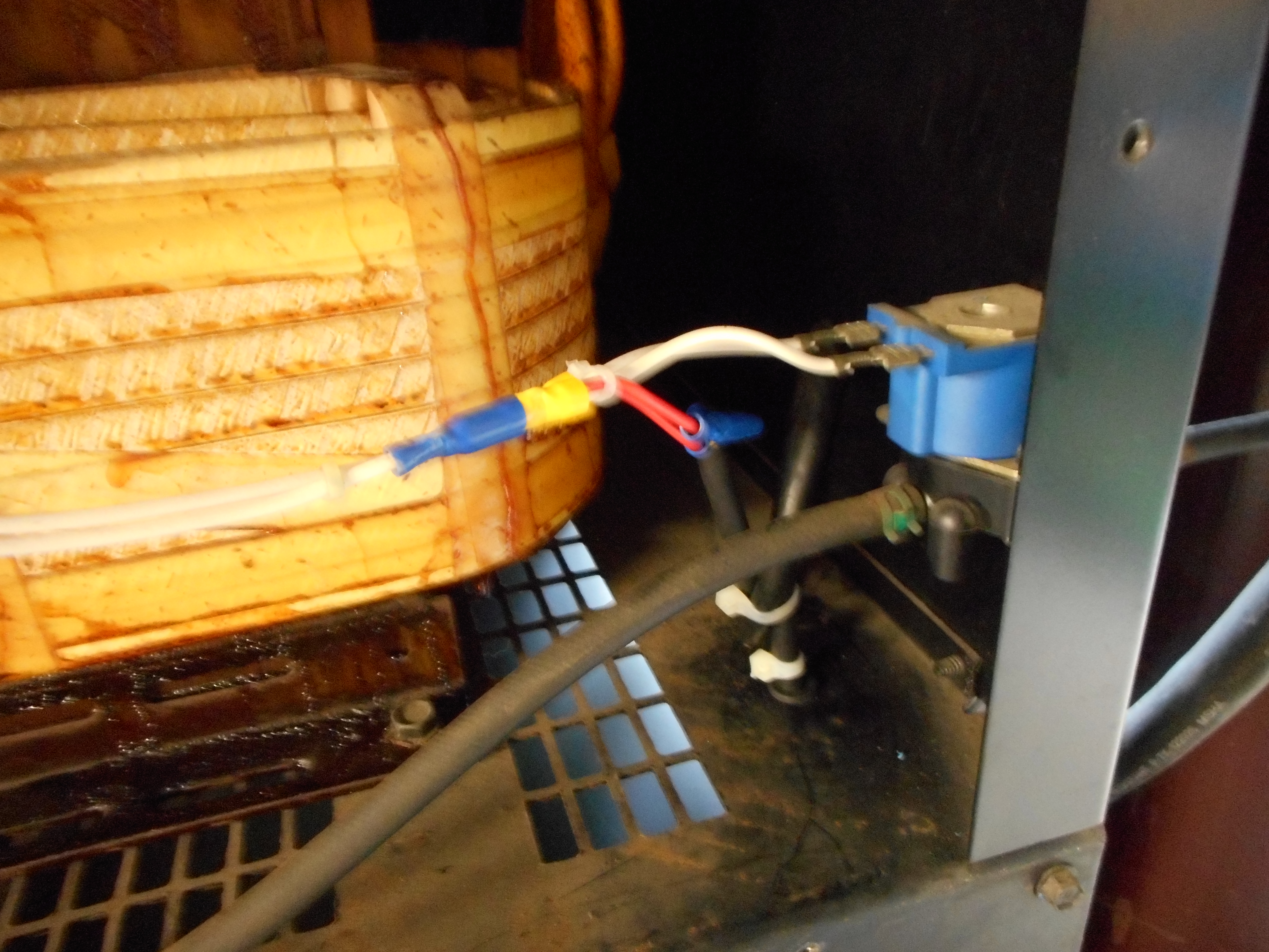

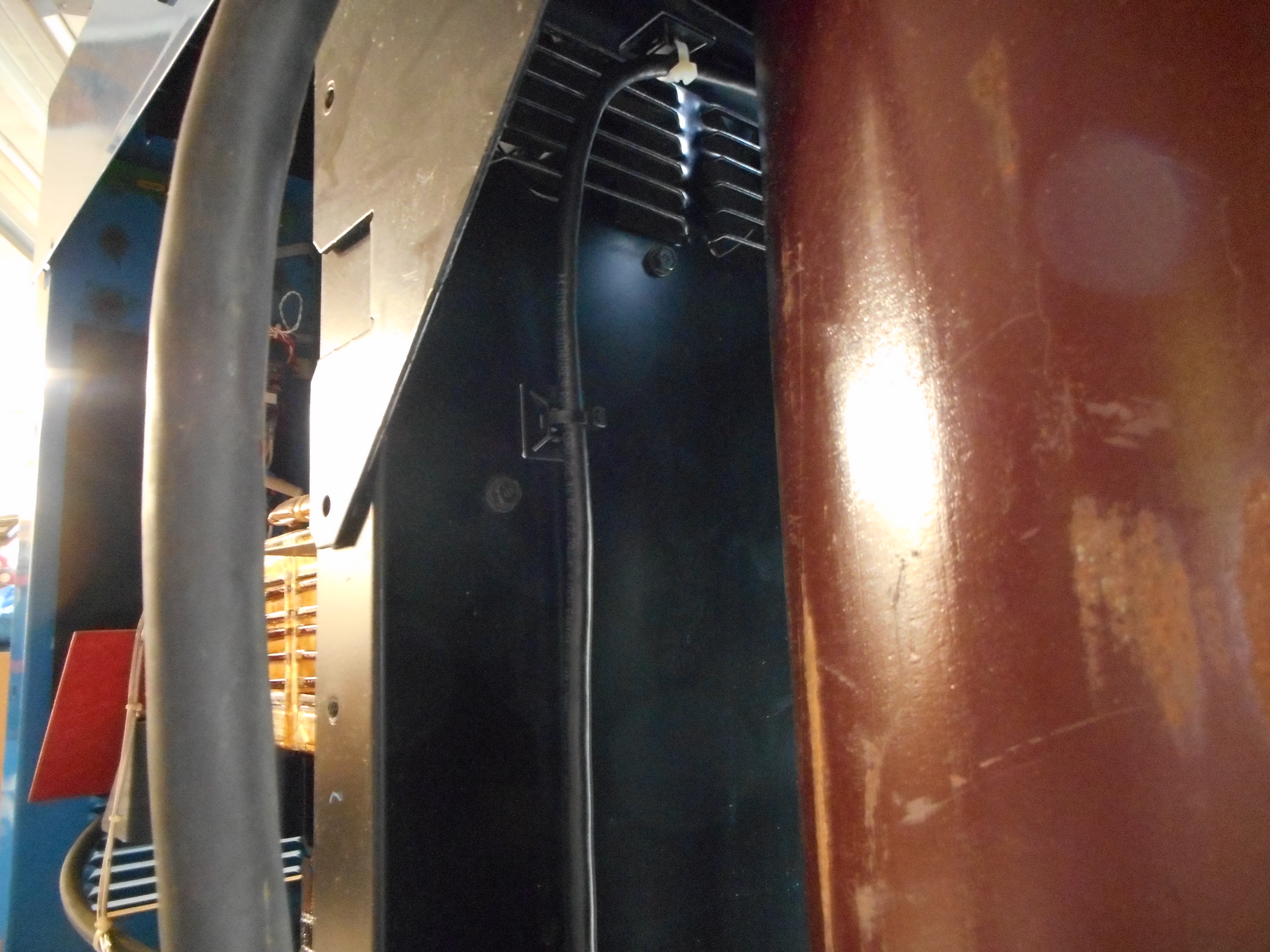

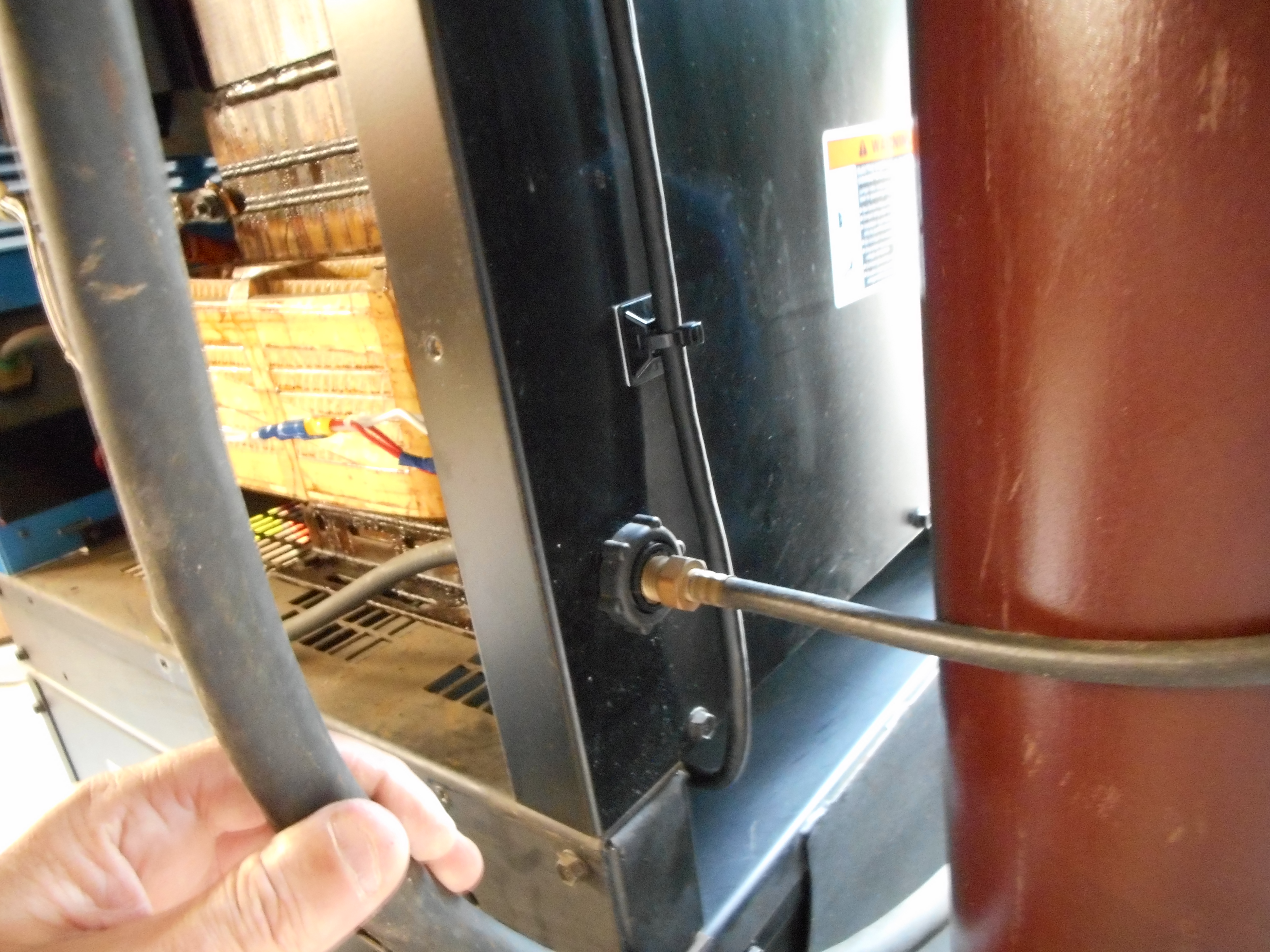

Executed!
After talking to a Miller rep and being assured that the factory 24V circuit for the torch solenoid had plenty of oomph for a 2nd one, I ordered one in and got it installed a couple weeks ago. Just got around to using it today and I couldn't be happier with it. While it's great not dealing with having to manually turn the valve on now, it's even better knowing it's impossible for me to forget to shut the thing off when I'm done... which has happened now more than once with the manual valve. I added the toggle switch so it can be turned off when not needed. And when I need to purge an exhaust system or the like, I'll just come straight off the regulator, bypassing the solenoid.
Thought long and hard about mounting the valve inside the machine but wanted it in a monitorable location.
Couple shots of my install. (sorry for the blurred wiring shot, hence the diagram)
