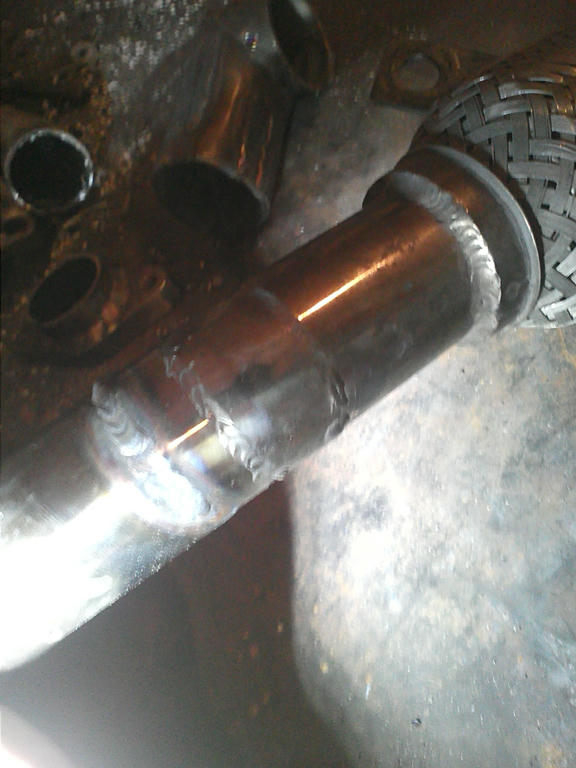

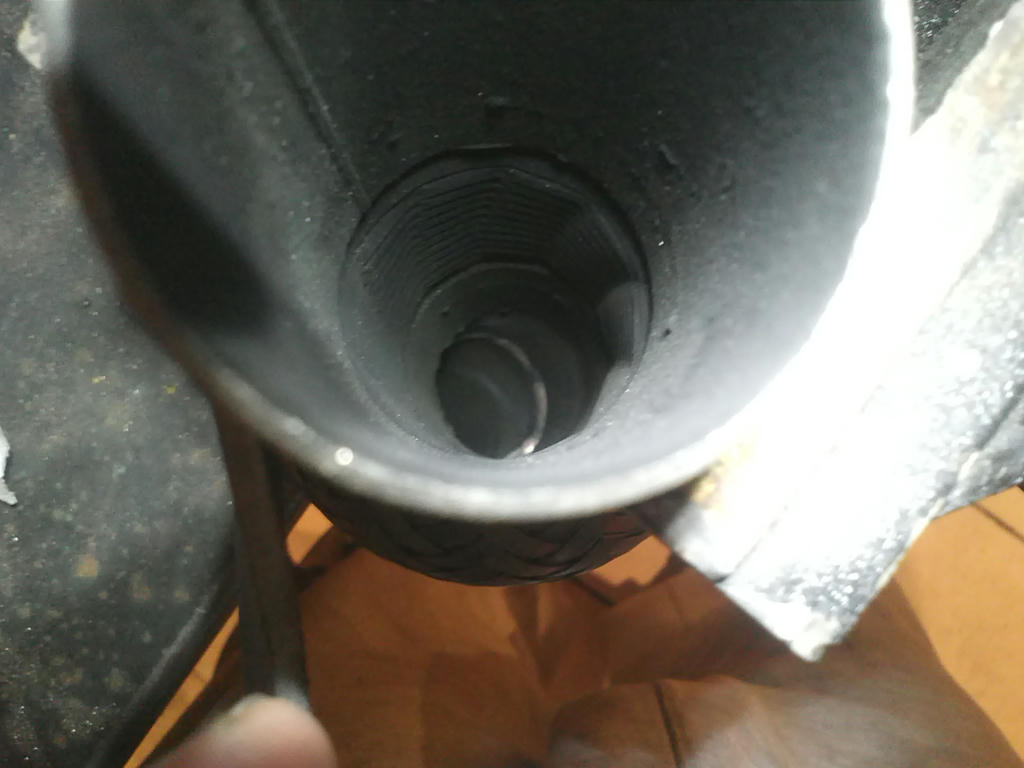

Hello from a newbie. I have the same problem and i ve experimented with more argon flow with a little better results. Still need much improve.. I can make a fairly enough nice weld at 2 pieces but i need to weld pipes and there the troubles begin. Any help appreciated! Photos of destruction..
