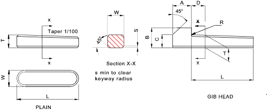

The gibs key is most probably tapered (See Fig. 1 & 2 ). That means the key has a slight angle, about 1-5 degrees, on its upper contact face with the belt pulley. Anything less than about 7 degrees is a self locking angle so the friction holding it in place has the potential to be very high.
Drilling
A taper makes drilling it out a’bit more complicated. You must center on the end of the gibs key that contacts the crankshaft when drilling. On a ridged drill press or knee mill the operation would not be an issue; however, attempting to drill it free hand, in my opinion, would not just be difficult but risky too. A broken drill bit would be a game changer. It would increase the work effort required for the repair. It would subsequently also increase the price of the repair at the machine shop.

- Fig.1
- keyway_3_46.gif (7.01 KiB) Viewed 2932 times
- Fig.2
- keyway_taper_46.gif (10.07 KiB) Viewed 2932 times
