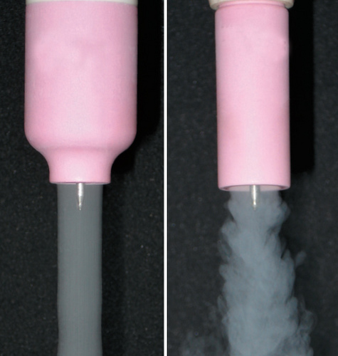

Hello folks,
I am thinking of upgrading my model 17 air cooled torch to a gas lens. I have been using my air cooled torch with the short alumina cups. Most of my welding is done to join mild steel, aluminum (once I develop the right skills) and rarely stainless steel. I know the gas lens will improve the gas coverage of the weld and should help reduce gas consumption by allowing a reduction in gas flow.
Is it worth it to change to a gas lens setup?
Any advantage or situations where a gas lens setup is not preferred?
Thanks!!!

Hi - I think it's largely personal preference based on what you weld - my latest tig came with a very flexible WP17 air cooled torch & funds were tight so I kept it - due to difficult shape joints on small tube I got a gas lense - I would have liked a short one ,but never found them available in the UK - since using it I found generally you can drop 25% flow of gas compared with a standard cup & the ability to use a long stick out makes it worthwhile - I seldom remove the gas lense as with this 1cup & 2.4mm tungsten nearly any job is possible without changing setup so was a good investment - however - if funds permitted I would park the air cooled 17 - keep it for odd jobs or going out on site & get a water cooled WP20 - including gas lense - having used both at a shop I would save your money & change to water cooled - even a cheap Ebay torch & cool it from tap water running to waste - I think you'll be better off long term - till I tried one I just thought Jody had a fetish for them - but as usual he's right !
If you can afford it, go for it. But, if you are new to TIG welding I think it better to learn without it, with tungsten exposure closer to the cup, especially with aluminum. I have used both and it really is of no benefit to my work. I find it better to use a more compact setup, and then customize accordingly as needed.

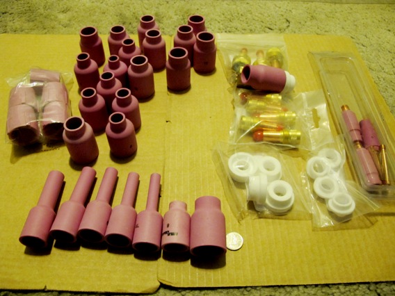

I purchased some gas lens parts for my WP17s a couple of years ago. I have not looked back. I purchase most of my consumables from weldingcity.com. The gas lens parts you need will not set you back very much. Go with the medium gas lens as the large gas lens is really LARGE. I can also recommend their WP17 and WP9 flex neck torches. For $10 they are hard to beat.
On the other hand if you want to go with the stubby gas lens for the WP17... It seems to be available only from Weldcraft at the moment and will set you back a little more. At least until weldingcity gets some in stock

The biggest benefit I found for a gas lens was when welding outside, where I had limited ability to control the draft near my weld. It was a big help with gas coverage.
I prefer a gas lens now, but simply because I'm used to it, and it affords me more stick-out for difficult to reach welds, including coverage for the "bent tungsten" trick.

My local supplier wanted a small fortune for TIG parts,
so, I bought my gas lens parts from http://www.weldingcity.com via eBay.
I bought a few medium gas lens parts, but mostly the largest ones available.
For $80 I bought lots of fun stuff to experiment with, mostly as a hobbyist.
