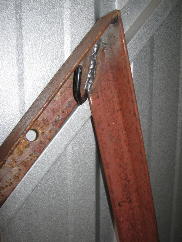

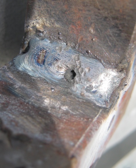

My name is Chris and I am a welding novice. I like to design and build things, but where structural integrity is required I get someone else to do it for me. However, I want to change that. Starting with welding light steel, I would like to move to chromoly and maybe one day learn to TIG aluminium.
So I went out and bought an $80 buzz box AC arc welder and a packet of electrodes. The most common rod in Australia is a 6013, and even the pro welding suppliers will recommend it. Anyway, I have been mucking around with a few projects, the latest of which is a hoist for my motorcycle. I want it to be able to hold about 100 kg or so; just the front wheel off the ground sort of thing. I found a bunch of galvanised pipe and some 2 mm square tube and got to work. I downloaded a tube miter program - brilliant invention!
So far so good, but I have been noticing my welds are taking in significant slag inclusions. It seems the angle of the electrode has a fair bit to to with it. My welds are hugely improved on when I first started scratching around, but I can't seem to shake these slaggy wormholes. This was one of my best welds - I found that I could get a good burn going for about 8 mm, then I would have to lift up and wait for it to cool a bit before going again. If I tried to do it in one pass the tube would blow out.
Stopping and starting didn't always leave inclusions, and this had a bit to do with the electrode angle - not too steep but not laying down either. I'm drawing about 90-100 amps (it's not real reliable) and 40 V at open circuit (it sags down to about 24 V while welding). Electrodes are 2.5 mm, but I found little difference between these and 3.2 mm rods. Both are 6013s.
Any advice is much appreciated!

You're doing remarkably well for an $80 buzz-box with an open-circuit voltage that low.
Part of the problem is that you're welding on galvanized. Beware the fumes. They're not really harmful, but in excess, they'll make you feel like hell for about a day.
Either get away from galvanized, or grind every bit off anywhere near your weld, and I think you'll see an improvement.
On material that thin, it's not unusual (escpecially with a low-end machine without good current/voltage control) to have to stop and start to keep from blowing out the pipe. To avoid inclusions in your stops and starts, use a wire-wheel in a grinder on the slag before you start again.

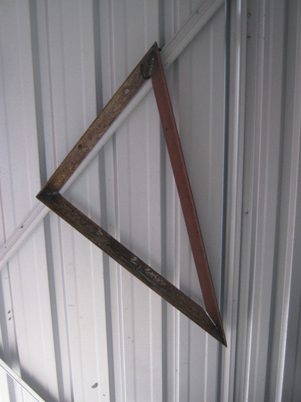

Thanks Steve - I must confess I'm not a complete newcomer to welding, but I am a newcomer to 'trying to do it properly this time'. I have built a welding bench from 6 mm steel so I can clamp stuff to it to hold it steady and in place. It also soaks some heat out of the weld. Welding big stuff is easy - the table came together pretty well with high amps and a slow travel rate, but the thin stuff is where I need practice.
I could go out and buy a MIG but then I would be skipping the fundamentals of welding metal. Plus the stick is just so damn easy to set up and go.
Agree on the galv - I usually grind it all off but the welds will still have inclusions. Maybe part of this is me moving too fast in fear of blowing through the pipe, and the majority is technique I suspect. Getting the welder set up could be a factor, but I found myself going back to the same old 40 V / 80-100 A range. The welder has a 70 V and a 40 V setting, for low (60-80 A) and high (80-130 A) currents, respectively.
Anyway, practice makes the welder. I need more projects before I can move on

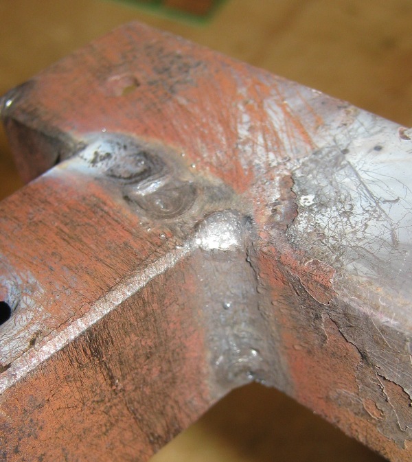

Well typical problem when using 6013 welding electrodes, worm holes and at times slag inclusion in the welds plus of course a low penetrating electrode. Used to be my problem before but sure bit the hell out of it by just continuous/constant practice on several materials, thick or thin. Have you tried using 1/16" or 3/32" 6013 rods on thin wall metals ? Them rods are more forgiving on thin walls specially when using a DC weld machine. You'd see the big difference.

The 48 mm pipe was welded with 3.2 mm rods. I tried 2.5 mm rods and to be honest they felt exactly the same, although they had less of a propensity to blow holes. I'd say I will continue using the 2.5 mm rods on thin tube (even down to 1.6 mm wall thickness) but 3.2 mm rods for big stuff.
I suspect if my electrode angle was a bit steeper I might avoid some of these inclusions, but surface preparation, having a nice tight joint to weld and getting the angle right will lead to the results I'm after.
There's a lot of bagging of 6013s out there, but it is pretty much the only electrode you can get your hands on here.

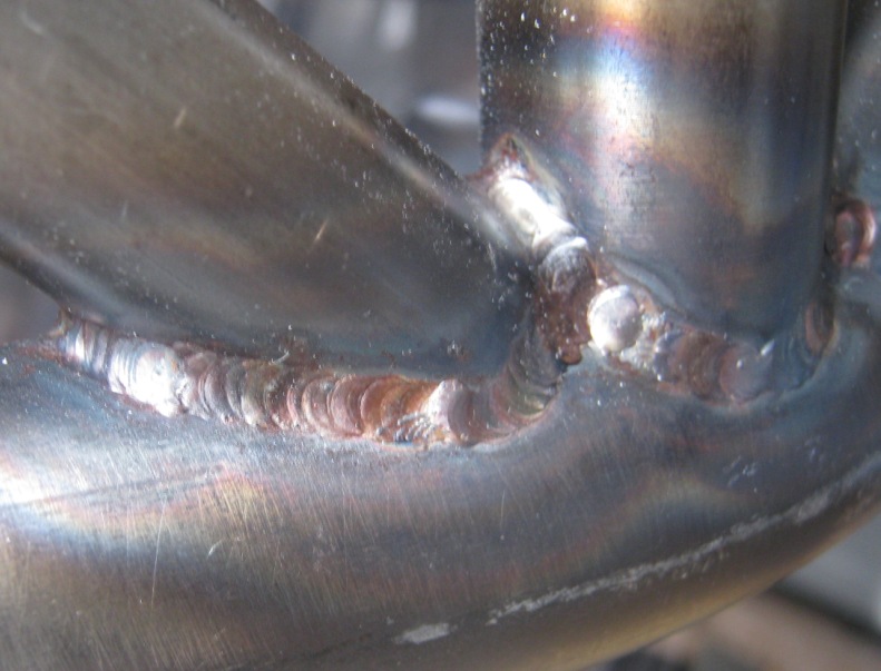

Since this is a welding forum, I might share a couple of pictures of my bike. I got Randy Ilg from Framecrafters to build it for me. I designed the basic shape and layout of the frame and they did the rest. Man, these guys can weld. TIG I assume, given it's Chromoly.
Sadly, no-one in Australia was keen to help with the welding of the frame. In the end I was very happy to get Framecrafters to do it as they have a long history of building beautiful, fast racing machines. They are explicitly NOT chopper guys; all they do is build race bike frames, which was exactly what I wanted. And for a bargain price too IMO.

I hate to tell you this, but I think they MIGged your chromoly. Those are some sad looking welds for some very expensive steel, and TIG does not leave spatter.
It looks like they pulsed it, with overlapping spot welds.
Sorry to be the bearer of bad news, but I'd both be angry, and afraid to ride the bike on anything less than a smooth flat surface.
I'll dig, and show you a pic off what that SHOULD look like, and you'll see what I mean.

That's what chromoly should look like, and it's not perfect by a long shot.

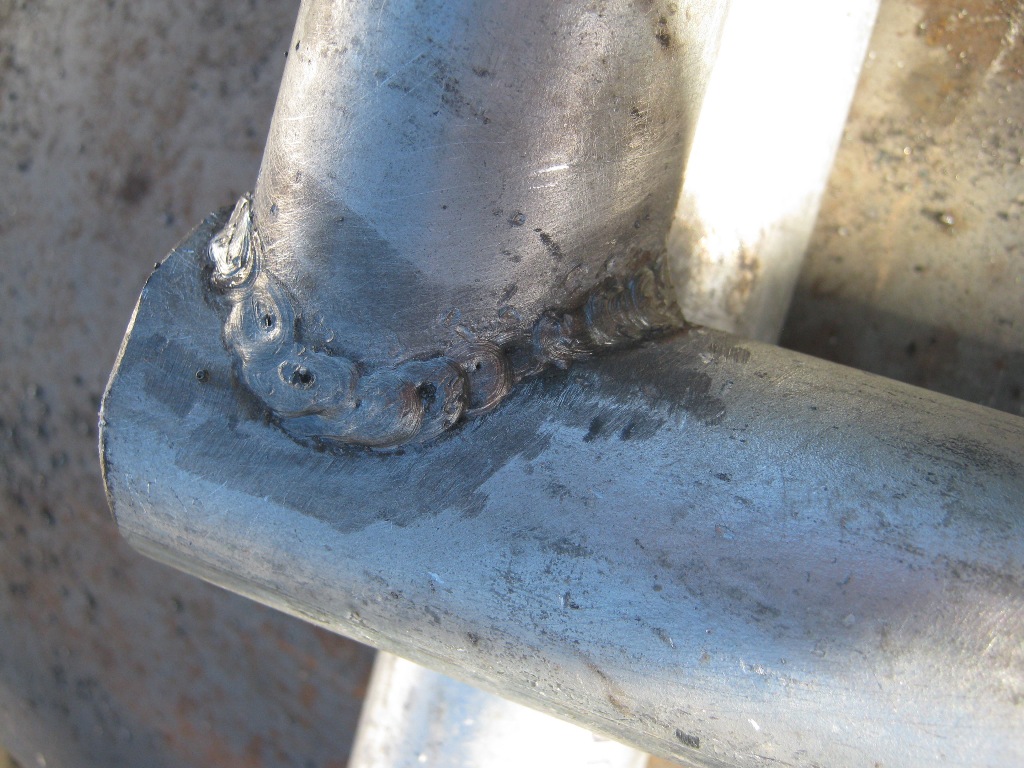

Thanks guys! I picked up some 2.5 mm rods from Osborne Park Welding Supplies. CIG weld Satincraft or something. Still 6013s though. I found no difference between them and the Bunnings brand stuff, but my technique has everything to do with it
For little 25-30 mm welds, I cut the electrode in half - the shorter rod gives me more control. Any electrode which results in fewer slag inclusions I am keen to try.
I had a bit more of a play with the welder today. Flies are getting really bad in Perth now, so I ran out of patience by the afternoon. I was playing around with 1.6 mm square steel tube doing butt joints on the 6013 2.5 mm rods. Something I am finding is that unless I have the amps cranked right up to about 100 A or so, the weld penetration is really poor. Trouble is, blowing holes through light steel is a cinch at this current. The difference between good penetration and holes is about 1 second!
I did get some satisfactory welds, but only if I ran a hot electrode for about 15 mm and stopped, let it cool, chip the slag and brush, then while the tip is still hot, get back into it to finish the pass. I'd get an inclusion, but no holes at least. Will upload some pics in a minute.
Sure, a MIG would do the light stuff much better than stick, but stick is just so convenient!

You are going alright. Those electrodes go alright. One trick for 6013s is to hold at the start of your run for a second, even with a slight jiggle of your rod, this allows the pool to heat up, float the slag out and push it to the back of the pool. The way to know if you have a nice weld forming is the slag will form a definate line at the back of the pool. If you are getting inclusions, you wil see the slag swirling around all over., Another good way to learn is to crank the heat up, way past you would normally use, this will generally force the slag out and back, do it on thicker steel, so you dont just burn through.

Well today I built myself a Pythagorean triangle. The objective is to get a perfect right angle; one my store-bought squares will hopefully agree with. I just took some angle iron and measured 750 mm, 600 mm and 450 mm and cut them at the approximate angles (53/2, 36/2 and 90/2). I filed them down to a perfect knife edge, making sure it was still square to the flat of the angle iron. I swaged the 36 degree corner on the outside first, then pulled or pushed them so the 450 mm section squeezed in. Then after tacking the 53 degree angle I checked the last angle, which was hopefully 90 degrees. According to my store-bought squares, it wasn't
It was bloody close though, so I just welded it up anyway. I filed the corners so they were flush and started comparing it to other "square" things I had lying around. It varied, sometimes more, sometimes less. I even used my wife's sewing mat which has a grid of imperial measures, and it agreed with it perfectly. So maybe it is right and the store squares are off? That would explain why I had so much trouble getting my steel frame square yesterday.
I guess the only way to do it would be to make a gigantic Pythagorean triangle, or at least a 45 degree one. The hypotenuse of a 1 x 1 triangle is always sqrt (2), so that might be a more useful one as 45' is a handy measure - certainly more useful than 53.13 degrees...
The way to tell if you square is out is to put it on a straight edge (edge of bench) and draw a line up the right angle blade. Then flip it over and check against this line, if its good, the line will be the same as your square, if its out the square will show an angled gap.

Not accounting for the kinks already in the angle iron, I got two parallel linesweldin mike 27 wrote:The way to tell if you square is out is to put it on a straight edge (edge of bench) and draw a line up the right angle blade. Then flip it over and check against this line, if its good, the line will be the same as your square, if its out the square will show an angled gap.
Hey,
Thats good, on things like that, if you can get it to under 3mm over a metre, you're doing ok.
Mick
Mick

I had my first paying welding job today! Well, the job was for a friend, and the pay was a carton of grog, but still
My welds actually looked really good - strong, concave and no blow holes. Only a couple of tiny inclusions too. I was welding 1.6 mm steel tube for the most part, and then welding 4 mm plate steel to the tubing. He even said "Geez that stick welding looks so much neater than I expected!" I should get him to send me some pictures to share, but in the meantime I'm just pleased to have reached this level
Might have me another beer...
