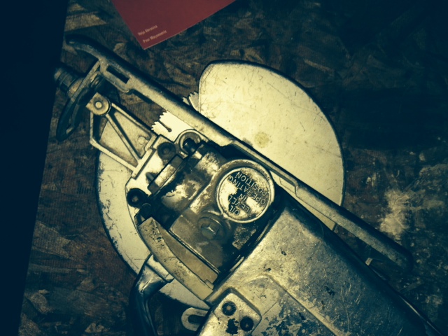

I bevel plate with a metal cutting skilsaw with the angle cut mechinisum
works like a charm
works like a charm
AKweldshop wrote:I bevel plate with a metal cutting skilsaw with the angle cut mechinisum![]()
works like a charm
I will post a pic of it here soon

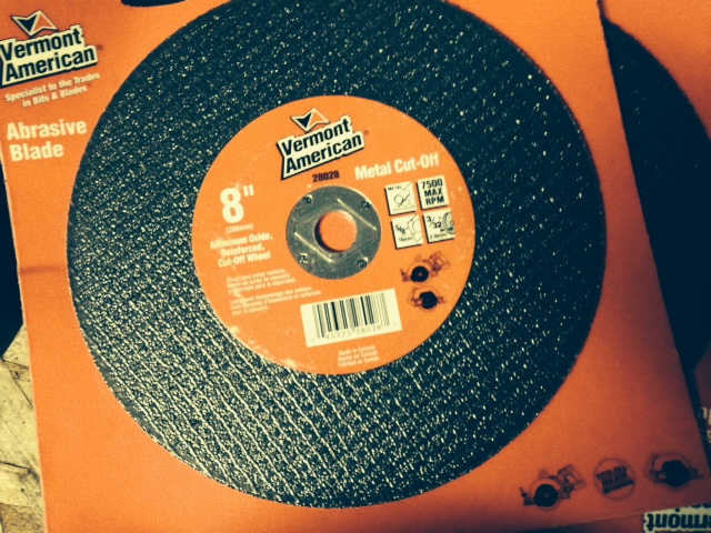

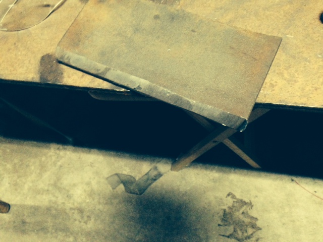

AKweldshop wrote:AKweldshop wrote:I bevel plate with a metal cutting skilsaw with the angle cut mechinisum![]()
works like a charm
[attachment=2]photo.JPGThen I dress up the bevel and land with my big ole grinder
20 bucks for the saw, and blades are $5
