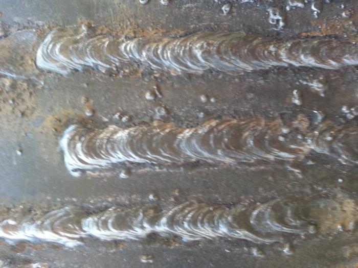

camlott55
    Tue Jan 21, 2014 4:44 pm
Tell me where I went wrong and any suggestions and tips would be appreciated.
I was using 6010 at about 95 amps...

camlott55 wrote:Tell me where I went wrong and any suggestions and tips would be appreciated.
The only thing I see wrong is you aren't "welding".
"Weld" two pieces of metal together and show both sides after you're done.

Travel speed and timing
Maybe a little cold on the second one
Practice, practice, practice, take a look at Jody's video on running beads on a flat stock just like you are. Rod angle and speed and watch the puddle forming behind the arc and try to keep it as constant in size, width and height. Also keep an eye on the length of your arc, looks a bit like your long arcing a bit but that gets better with practice

camlot55, this should help you considerably....
http://welding-tv.com/2013/11/05/6010-pad-beads/
Go get 10 more lbs and start burning rod.
have fun,
John

Marc Godwin wrote: Practice, practice, practice, take a look at Jody's video on running beads on a flat stock just like you are. Rod angle and speed and watch the puddle forming behind the arc and try to keep it as constant in size, width and height. Also keep an eye on the length of your arc, looks a bit like your long arcing a bit but that gets better with practice
http://www.weldingtipsandtricks.com/stick-welding.html
+1
I watched lots of Jody's videos, and still do the night before I weld - as mental refresher.
