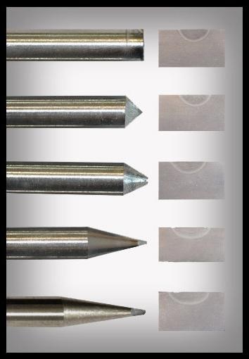

20 degree tip is not necessary for 1/8" metal.
Here is some background on tip profile.

those are bad ass graphs thanksMinnesotaDave wrote:20 degree tip is not necessary for 1/8" metal.
