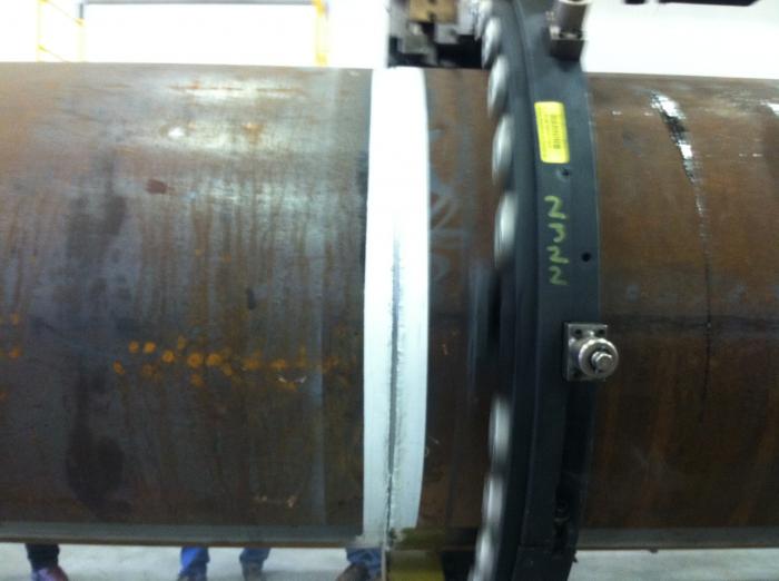

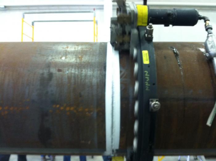

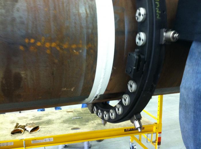

We had MTI Power Services bring in their split frame beveling and cutting machine for a full demo. The project we are working on (seen in "what I welded today" in mig forum) using 30" pipe, we are looking at solutions to extracting a weld if it faile non-destructive testing or if for some reason we needed to cut a pipe apart. While the machine performed flawlessly I would like some opinions from others here. Keeping in mind this machine is to go into a portable welding cell that we are in the middle if engineering and the key is speed, I don't think this is the best option if a 6" section for example fails x-ray, to extract the entire diameter and start over. You can set a depth in you know how deep you need to go but I feel it would be quicker to use a grinder for a smaller repair like that. If you need to extract a longer run than this machine shines. One benefit is it cuts, preps and you are ready to go.
So here is the way I see it for now
Advantages; faster cutting and beveling verses other methods, easier cleanup,
Disadvantages; have to excavate entire parameter even if small section is defective, long set up time even when set to correct diameter, impregnates cutting fluid in weld zone leaving chances for more future defects.
So what do you think? Also if anyone has used these in the field I would like your feedback.
I took two very quick videos that I will get uploaded when I can, until then here are some pics and a link to their video.
https://www.youtube.com/watch?v=yXQd3QEXH5U

I watched the video you linked to and have a question. You said, "Disadvantages; ...impregnates cutting fluid in weld zone". The video looked like they were cutting dry or I did i miss something. What drives the cutting head around the frame?

That's a great idea - but if the cutting action is as it appears using what is essentially a lathe tool being driven round the pipe & a cut increment indexed each revolution ( I assume at the point the rotation slows / pauses unless that's a camera trick ) I doubt it would work as the cut got deeper the distance required to establish the cut depth would be too great - the cutting head would need to be a powered / rotating action more similar to a large tipped milling cutter that could cut directly into the material before moving round the pipe - I have seen a system sort of similar but no idea who makes it - interesting concept - I assume it's primary function is just to create an accurate face cut / edge prep prior to welding rather than removing a defect - though I guess if it was say Tig root with no faults but stick fill / cap & there was a slag inclusion or other fault you could take it back down to below the problem without cutting the entire joint & re- filling.

Like most demo videos, they show only what they want and always in the best case situations. They don't use coolant in the video to my knowledge but in real life they suggest a water based cutting fluid. Now one argument is you should/might pre-heat before welding again. As for the power, it is air and it is the long black canister off to the right side.

Yes this might be possible however it would need a redesign. As seen it is air lowered and they do offer a hydraulic version as well. It is based off what Brian suggested, it is a cutting tool that advances .004 each time it trips a lever. I did think of the situation Steve suggested going a certain distance and going back but it would have to be alot more advanced than it is. One of their selling points is easy field use with air. There is a machine out there that could clamp around a track and cut into the weld like a chop saw. The draw back is it only cuts straight in and you still have to do the beveling.
