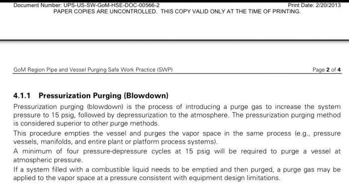

This is the method I use (for propane and gasoline, I haven't worked with any natural gas):
Full document: https://hssestorage.blob.core.windows.n ... urging.pdf
I'm puzzled why you would be tasked with welding this pipe without training.
- image.jpg (48.63 KiB) Viewed 4856 times

Use (cheap) compressed nitrogen to clear the line of gas. Not air, as you don't want to introduce oxygen (for obvious and less obvious reasons). You CAN, frankly, weld on this line with nitrogen as the backpurge. There are many topics of discussion here that support this. There's virtually zero hazard welding this as long as you exclude oxygen from the inside of the pipe.
Also, what Dave posted about pressure purge is quite good. I use this method frequently, though I'm usually purging from "atmosphere" to "nitrogen". I've occasionally done it to change a pure hydrogen hazardous atmosphere to nitrogen.

Yes gas ( CH4 ) will in fact impregnate the metal. You should weld anything that has had any flammable gas in it with a constant purge. Argon would be the first choice, but on Carbon steel you can use N2 or CO2.
If you have a flange at the regulator you should use a blank to be sure nothing gets by it. If you can break a flange further down line, blank it also.
Dave's procedure is dead on if a constant purge is not possible. The cost of the purge gas is cheap in comparison to a person being injured or worse.

Will pressure up to 15 psi 4 times the keep a constant 10 psi purge wile welding
I assume you meant 10 CFH, as 10 psi would make the weld hard to close...
The presence of combustibles in the line is relatively minor, as by this point you've reduced them below the lower explosive limits, and the purge eliminates oxygen making combustion impossible. I speak as someone who welds on piping and vessels for liquid hydrogen service, with the widest "explosive limit" range there is.
