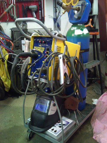

I'll start with the "mandatory" cart that probablty is one of the first welding project for most beginners.
Made this one for my first tig and later modified it to fit my new welder that was slightly larger.
Some people told me I could buy a cart for 100$ but as I said, what fun or challenge is it to buy something that you would rebuild later because it would lack rod holders and even cable hangers?
So I made my own as I wanted it, with rod holders and a holder for used rods and a holder for the torch so it can be placed hot without burning the cables. Holders for the power cord and the ground clamp, and of course a dedicated place for the tig-finger . Tilted the welder slightly upwards so I can see the display stranding next to it
The back-bone is two 1" black pipes that holds everything. Tank is strapped between them with two hose straps.

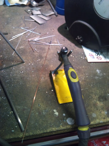

I never liked the magnetic torch holders but I have a bad habit of stepping on the hose and dropping the torch on the floor so I made a somple torch holder where I can just drop the torch and lift almost without looking at it.
Havent broken a single gas cap since I made it.
Just two 1/4" rods bent and welded to a bent plate

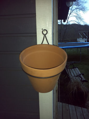

Made some clay-pot holder recently where they wanted them to hang on the wall in an angle.
1/4" rods, rolled and welded
This is not where they were supposed to hang, just to get approval for the design

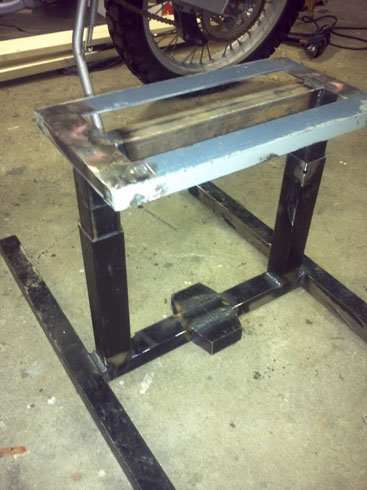

Working on a bike with my son.
Made a stand from recycled material using a bottle jack and the square frame frome my old welding cart
Made a plug for the exhaust required to make it street legal.
Was removed by the previous owner, cant be bought and a new exhaust is 500$...
Made from 1mm sheet a fusion welded, except at the end of the cone. Could have cleande the sheet better...

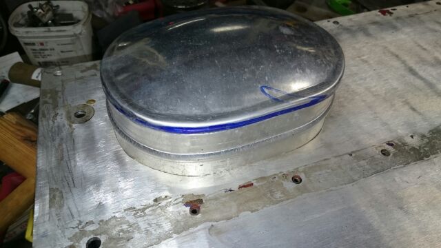

Did you use flow forming or just hammer it out?
Looks like a good candidate for flow forming.
I used a mdf form with routed edges to hammer the lids on.
The torch and the flame was pressed using a steel die and rubber.
Have about 30 hours in it

Even with a form, that's some pretty fancy hammeringAndersK wrote:I used a mdf form with routed edges to hammer the lids on.
30 hours is a lot faster than I would have done it
About the same method as in the later posts in this thread:motox wrote:this is not a welding question but i am interested how you were able
to make such nice curved corners on the bottom and lid of the aluminum
torch case?
http://forum.weldingtipsandtricks.com/v ... 505#p35702
but working on the outside of the wood with hammers and mallets
You can google hammerforming for more info about this method
