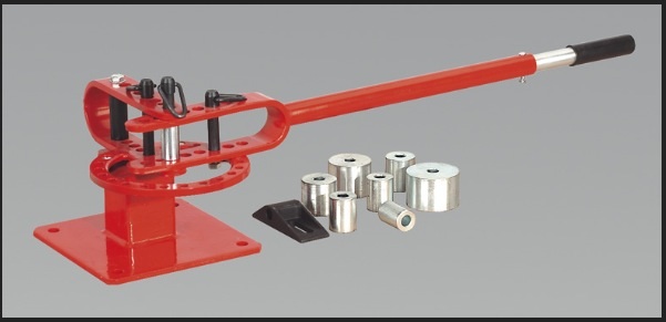

You can also bend the test piece around a die - one of these bench top models can be made pretty easily.Adam's Got Skills wrote:hey thanks buddy!! That sounds like that's a much smarter way to go about it....Id really like to bend test it too but i don't have a press brake or anything..do u have any ideas about that??
- image.jpg (32.13 KiB) Viewed 3064 times
For $120 it's tough to beat

Well I got the backing plate off!!! An looked pretty good to me. Is that bender pretty tough? I think it'd b a nice addition to my arsenal of tools. Does it work on thicker steel?
