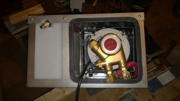

I made a tig torch cooler from an old washing machine motor. It pumps ok but not sure of the pressure mainly because it can rotate in the pump. It does seem to work. The torch and tig rod from the limited use i have given it docent seem to get hot.
I don't use a Coolant or distilled water but do change it after a couple of times use.
