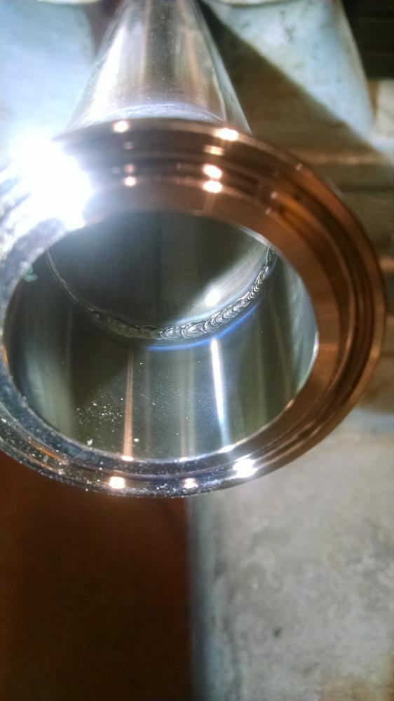

When you accidently reposition your pinky prop finger over the vent and blow out the last 1/8" of weld...lol man I was pissed. Had to cut the sanitary fitting off and re-weld.

I've actaully (and unfortunately) done that often enough that I recognize it coming on.
Ususally I see it about a half-second too late to stop it, but I see it coming. It sucks on a code weld.

Yeah I noticed the puddle acting funky right before it blew...been fighting a small dark/black area on my stops after I pickle, found my gas hose connection at the dinse was loose. Hopefully that was that issue, I liftee started everything but I may have to hook my torch switch back up, really don't need to taper off and its a little acquired with the pedal. Guess I'll find out shortly have about 100-125ft of pipe I want to get ran today.Otto Nobedder wrote:I've actaully (and unfortunately) done that often enough that I recognize it coming on.

That black spot is on outside of the pipe? Sometimes you can't avoid those black stops at the end of the weld. Those are just "inpurities" from metal or from your tungsten or gas. Nothing to worry imo as long as those are eliminated with pickling. Btw do you clean parts before welding?

Yes on the outside only, I just grabbed a new piece of tungsten as well the other had ran its course and was only about 1.5" in length...lol I wipe all parts down before welding. I'll report back later getting ready to weld some up after break.Markus wrote:That black spot is on outside of the pipe? Sometimes you can't avoid those black stops at the end of the weld. Those are just "inpurities" from metal or from your tungsten or gas. Nothing to worry imo as long as those are eliminated with pickling. Btw do you clean parts before welding?
Much better, I think my post purge was really lacking with the fitting loose at my dinse connector.
