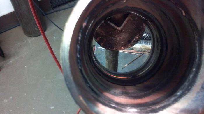

Couldnt get all pics in last post

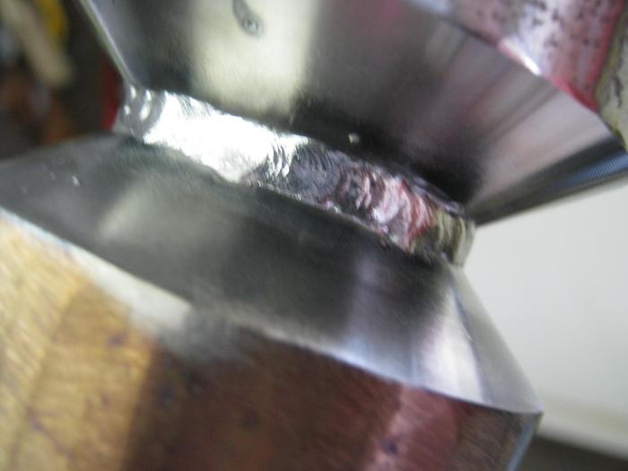

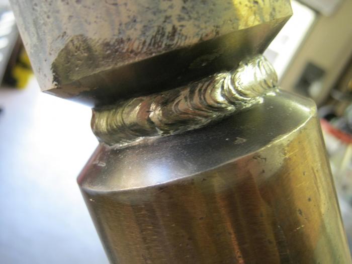

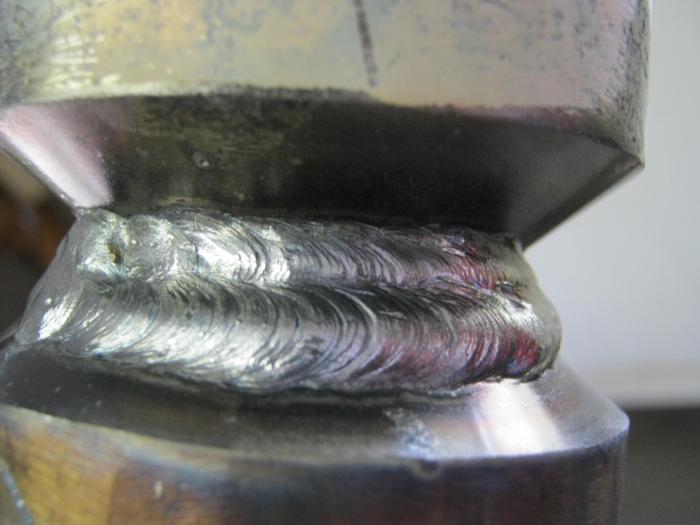

Mike,
First you are doing great. To think how far you have come in a short amount of time. Before I comment know that I am not that great at GTAW pipe and can only speak from what I see. It looks like the GTAW fill pass might be a little cold, the toes are not wet in very well. I don't think it is failing because of the arc force from the 7018 should be able to fill that in but just a observation. I believe the SMAW passes are fine and cannot fail them based on my knowledge of ASME IV. However, some might want the passes to flow a little better. Keep it up and knock em dead!!

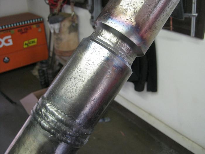

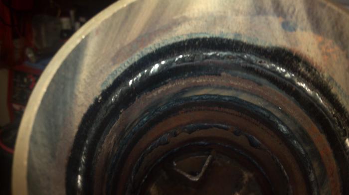

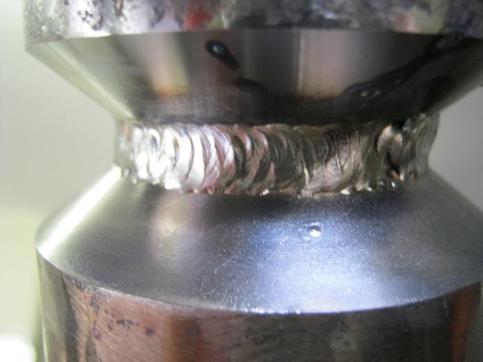

Thanks J...Yea first run kept it same amps so not to scale up my reinforcement....dialed it in on the next two sets..Tried one tign out a cupple passes..Did sm 4" 40 too..3/32 6010's...wata ya think ???..Gona do sm 2" SS today..see how that goes..lol

Mike,
I think what I've seen appears to be ready for x-ray. You're well on your way. Just don't screw up that 7018-out, and you're golden!
Aleksi is right. You just have to find your style. We all do it a bit different. Take everything you've learned, and all the tips you've picked up, and figure out what works for you, and you've found your style. (And keep watching and learning from others, to refine your style!)
