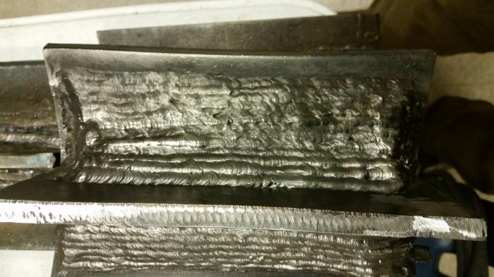

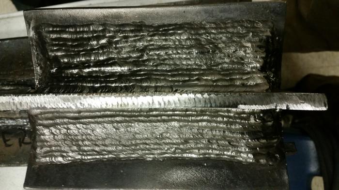

Here is a couple of picture for the latest project that we did in the welding program I'm enrolled in. Its a Tee joint with one side Horizontal in the 2F position and the other side in the 3F position. The bottom side of the joint is my Horizontal 2F and the top side is the 3F Vertical up. We did 6010 roots with 7018 filler passes just to get used to building up a weld joint. Just finished the 1st semester with great results. More updates to come!
- 20150206_125754.jpg (51.16 KiB) Viewed 2085 times
- 20150206_125752.jpg (57.03 KiB) Viewed 2085 times
- 20150206_125747.jpg (58.92 KiB) Viewed 2085 times
Good solid metal there. But the way the beads are crowning up and not quite blending into each other suggests not hot enough and or to fast of a travel. Good effort for starting out though.

looks really good to me. where are you in school at? my son starts a 9 month class at hobart in less than 2 weeks. i am sooooo jealous of his opportunity. - mark
A tad more amperage, and slower travel speed, should help the beads smooth out and wet-in to each other better.
The bottom weld in the second pic looks really good.

wow that's a lot of filler....good job.
