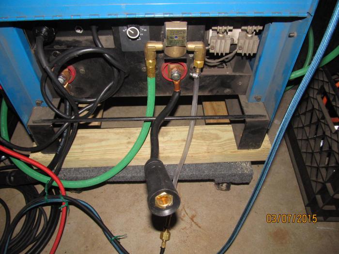

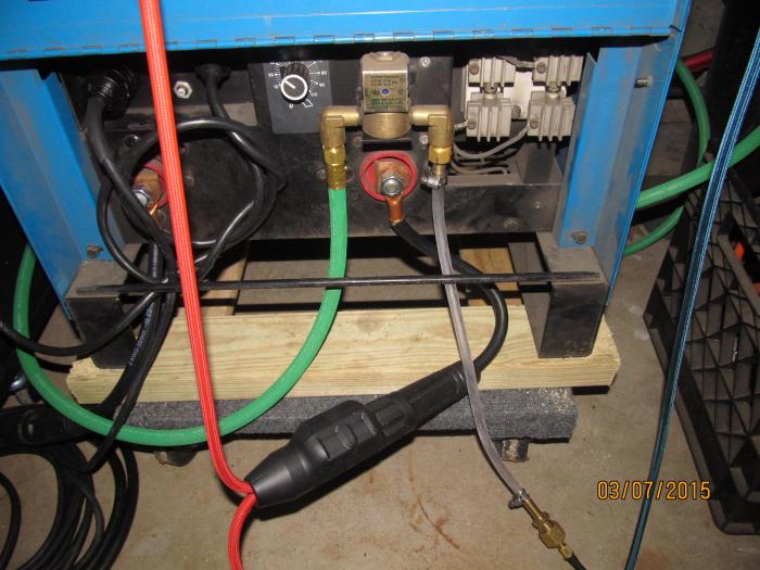

guys
one more question
looking at my 250 the lug to connect
the torch doesn't look like it has enough
thread to leave the tig torch hooked up
and put the connector for the stick torch.
is there something someone makes to
be able to do this or do i need to figure
out something?

    Wed Jan 22, 2014 12:00 am
    Connecticut
I don't have a good answer for you other than just switching them back and forth. On mine I have a water cooled torch, so my set up is different. I made a short tag lead with a DINSE connector on one end and a ring terminal on the the other. When I want to stick weld I unplug the torch from the DINSE and plug in the stinger.
Multimatic 255
    Connecticut
BTW, I did something similar on the ground lead as well, so I can plug in extension leads and weld up to 50 feet away from the unit as needed.

motox
    Thu Nov 28, 2013 12:49 pm
    Delaware
my torch is water cooled but I'm going to steal
your idea and add a tag lead.
