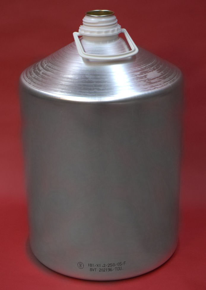

I am in a fix and i would like you guys to help me out to fix this issue. One of staff did poke an Aluminum can containing slightly fire hazard liquid (perfumery compound, not containing alcohol) while packing the outer crate. It pierced it though the side of the bottle can. I cant open the bottle can as it has a one time seal. We have kept the bottle can side wise to avoid the leak. I need to fix this ASAP and send the shipment on board. Is there any workable sealant? or any other idea to fix?

Hey. I don't think welding is the answer. Combined with the flammability of your product and the fact that if you heat the cylinder (besides catching fire/exploding) the contents will expand and force their way out through the weld metal during repair. Think "path of least resistance " that is what the molten weld zone will be. I don't think it's an option.
However, there are various types of chemical sealants, epoxies and what not that might work. Like JB weld, liquid metal, and we have a product in AUS called "knead it" which is a two part putty that bonds to metal. Just make sure what ever product you choose is compatible with aluminium.

Though the problem is solved, I would like to get know what could be a possible solution. The one solution which caught my attention was to rivet it with aircraft fuel sealant. (dont know where to get it though).
Sample bottle pic attached.

That looks like it might be a small "Dewar" flask, which would have an inner container holding the product, and an outer container holding insulation between the two.
If (big if!) this is the case, a weld repair would have been possible, if tricky.

You probably could use something from www.northsearesins.com/ . They have products to seal a leak that are cured with blue light. It's somewhat like the resin the dentist uses that is cured in a similar fashion.
