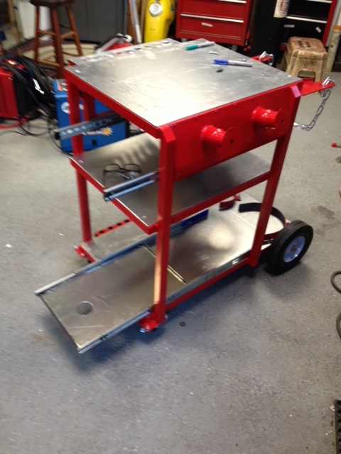

The Red ,I like the colour choice.
Red & green, Christmas in April.

mine is similar.
love the color
mine is similar.
love the color
- IMG_1586cart cooler tray.jpg (121.29 KiB) Viewed 2487 times

Taildragger, what a great job, looks ideal.
And welcome to the forum too!
