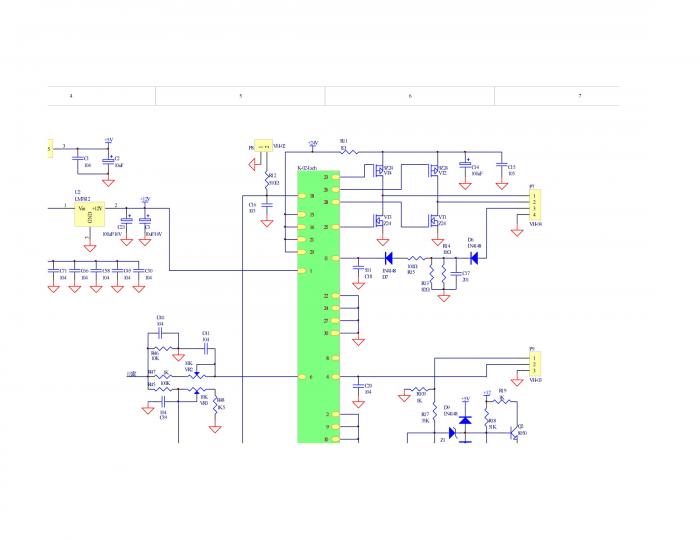

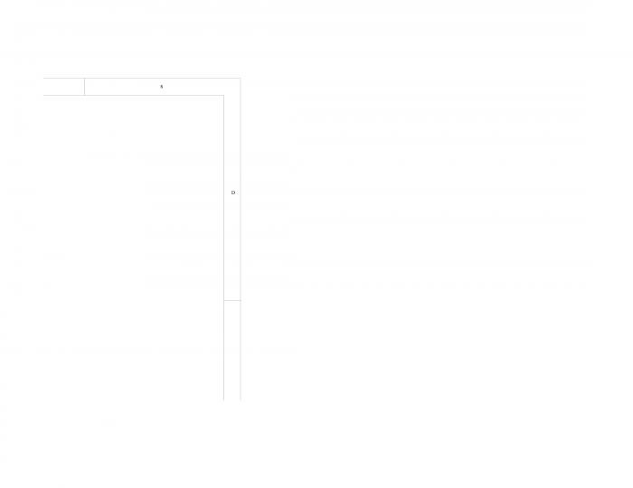

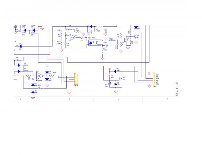

Hey Guys
Sorry its been so long for me to post this but here is the schematic for The Luxor 200P Inverter Control Board.
these are how they where sent to me. you'll have to photo shop them together or print, cut and tape them.

- Luxor 200p Main Control Board Schematic
