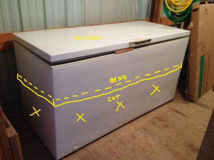

    Tue Jun 26, 2012 8:05 pm
I've decided that climbing up and down ladders to get on to the roof for maintenance sucks.
So, I've decided to make a set of stairs to get up there, from inside the building. ;)
I looked into the cost of roof hatches and they are pricey. $3000 +
I'm going to re-purpose a deep freezer in order to fabricate my new roof hatch.
The idea is to cut it and make some flaps that can be screwed to the roof.
The door lid even has a light inside, so that I can see where I'm going.
https://www.youtube.com/watch?t=59&v=BbhNiUC0OQg
deep freezer.jpg (35.53 KiB) Viewed 3844 times
Boomer63
    Fri Sep 12, 2014 11:52 am
    Indiana near Chicago
@Werkspace - Love to see the final result with that hatch project!

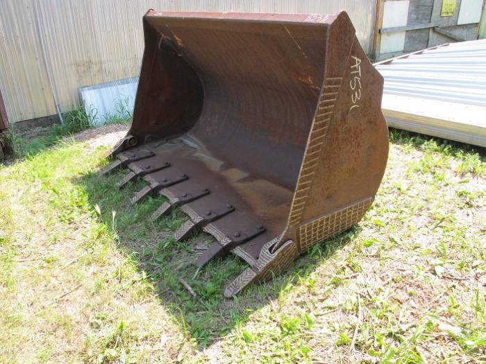

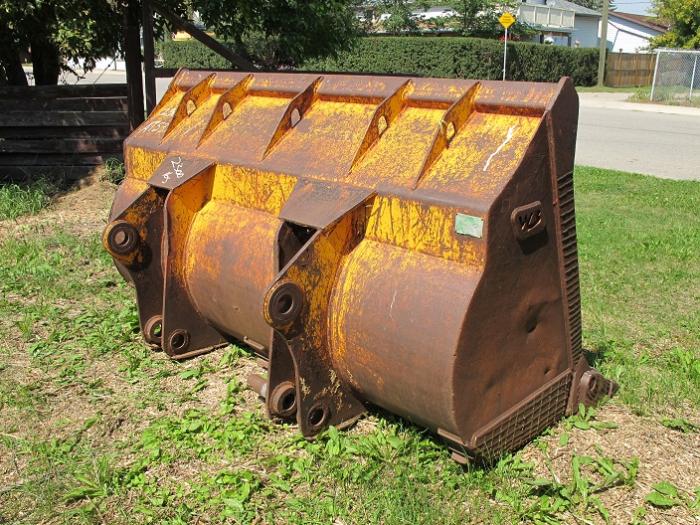

The JD755B bucket arrived today. 2.25 cubic yards. It weighs 2300lbs.
The loader can lift 6000lbs. so I'm still in the usable range.
Dimensions are 87"W X 50"H X 48"Deep
The bucket pin centers are identical to my loader.
It shouldn't take too much modification to match everything up.
I've decided to leave the bucket size as is. It's not as big as I first thought.
A bit of lathe work to make insert spacers for the bottom pins.
and some welding and fabrication to make up the top pin mounts.

Rick_H
    Sat Feb 08, 2014 1:50 pm
    PA/MD
That would be pretty slick and resourceful!
Bill Beauregard
    Thu Jan 24, 2013 9:32 pm
    Green Mountains of Vermont
Leave the ribs tall. You can create open hooks, and add hanging forks, very handy. The forks you have will never get used without a quick attach. Convert them to hook, and you can drive up to scoop them off the ground.
I've edited the bucket pics.
With a few modifications, it should fit fine.
It's actually really close to the size that I was looking for.
