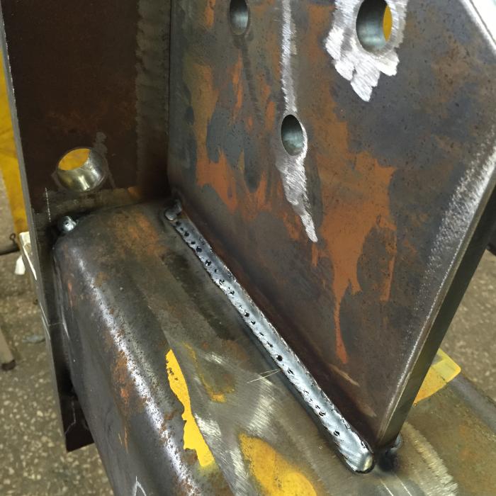

welditforyou
- welditforyou
Joined:Mon Jul 21, 2014 12:08 pm
Location:Missouri
- IMG_0078.JPG (57.11 KiB) Viewed 5543 times
- IMG_0077.JPG (56.13 KiB) Viewed 5543 times
PS; I went to attach some pics and cannot find a way to do that. wth! Why is that?
Jim
Fixed it!
The pics aren't in order. The top one should be last. It shows the weld after cleaning.

welditforyou
- welditforyou
Location:Missouri
- IMG_0075.JPG (58.73 KiB) Viewed 5543 times
- IMG_0074.JPG (66.21 KiB) Viewed 5543 times
I've been in the rail shop for the last couple of weeks using hard wire and CO2. I tend to push it as well most of the time not ALL the time.
