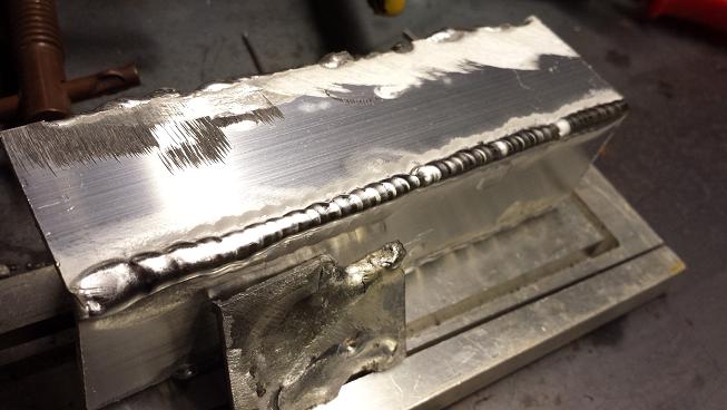

Hi guys, I've been MIG welding for a while and have just bought myself a TIG. I found that DC welding steel/stainless steel wasn't as hard as I'd expected to get started with and feel like I've begun to get to grips with it relatively easily. I mainly bought the TIG for the aluminium jobs I need to do though and have so far have found it pretty tricky!
I'm a hobbyist learning on my own so would really appreciate some input from some of the more experienced welders on this forum!
I'm currently practicing with some 2mm aluminium sheet I have. I've found that I can get a pool started on a flat piece of stock, then start creating a bead across the workpiece. It's by no means a work of art but it's got the basis of something I can hopefully develop into an acceptable weld.
The problem is that as soon as I go to do either a butt or a lap weld, everything starts to go horribly wrong and I can't get a bead to start taking shape.
My setup is:
R-Tech TIG161 AC/DC 160amp Inverter TIG.
Fresh, 1.6mm ceriated electrode.
2mm aluminium sheet.
20cfh pure argon/10sec post flow.
4043A filler rod.
Base current 55amps (a welding calculator suggested 65-70 but I think that was for a non-inverter and it turned out to be too high anyway).
No pulse.
Approx 55% AC balance, approx 110hz AC frequency.
I've checked most of the common "newbie" mistakes which I've found online. I'm holding the torch at about a 15 degree angle with my filler rod 90 degrees to the torch, I've cleaned the workpiece extensively by grinding the top oxide layer away or scrubbing with a stainless wire brush, then cleaning with acetone. I've used various "welding calculators" to get the setup right. I've tried using a chunk of aluminium billet as a heat sink.
Although I'm currently using these settings at the moment I've tried various other combinations and the problem seems to persist.
What I seem to find is that although welding on flat stock is OK, as soon as I actually go to weld one piece of stock to another, the edges sort of curl away from each other. This seems to be worse if I do an internal corner weld too.
You can see from the attached shameful image what I mean. The beads on the flat bit are taking shape but the edges look horrendous when I try and join one piece to another.
What am I doing wrong? Any help would be much appreciated!
Is there something wrong with my setup or is it just that I'm bad at welding aluminium? :lol:

Outside corner joints are going to be the hardest for a newbie to alum, fitup is important. You need to get the puddle fast and start moving.
Try turning the amps up a little and when the edges start to curl dab some filler, and keep moving. If I am understanding correctly it just sounds like you are expecting that nice looking puddle, you won't necessarily see that on a butt or corner type joint.
2mm sheet is thin to learn on, some thicker stock maybe easier to build beads on which will help get the feel.

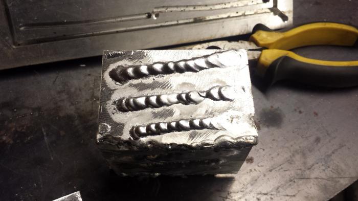

Your corner looks just lile mine did when starting to learn aluminum. I figured out later that I didnt used high enough current and tried to add filler way to early. You have to wait until you see a mirror puddle, and then quickly add filler before it curls away too far.
Was doing some 1,5 mm butt joint yesterday, at 75 amps. Backed off a bit after some distance when pieces got soaked of heat. Current control is crucial on thin aluminum so if you dont have a foot pedal try and learn to use up- and down slope and pulse with torch trigger.
I have a practice piece that was initially 4mm thich. After laying bead after bead beside each other its now 35 mm thick.
That help you learn consistent feed and travel.

Try setting your balance at 30% instead of 55%. If your saying the tungsten burned away at a higher number then your machine is set up like an Everlast and you are adjusting Electrode Positive. Miller and Lincoln machines are changing the Electrode Negative.

Looking back at your pictures, that is definitely the case. Your cathodic etching (white frosting) is almost as wide as the weld bead on both sides.
In this instance, you are getting your joint hot, but not using usable heat and just trashing the edges. Try it after you turn your balance down below 40 and see if you get the same results.

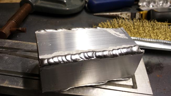

I bought some stock which was literally only about 1mm thicker than that stock I was practicing with and it seemed to make all the difference. I think I was just getting ahead of myself and trying to weld something which was too thin for my limited experience.
This was my first two attempts with the thicker stock:
I feel like these were much better already!
One problem I find still persists though is that sometimes, I'll be mid weld and things will suddenly go bad, even though I can't see that I'm doing anything different. You can see what I mean in the picture below, working from right to left, I start getting a reasonable weld going, then it suddenly changes. Is this because I'm doing something wrong or is it something like I've hit a patch of contamination?
The things which I've really learned so far is how much the amperage requirements change according to the material thickness and how much heat is in the workpiece. I'm starting to see the necessity for good pedal control.
GreinTime wrote:Your cathodic etching (white frosting) is almost as wide as the weld bead on both sides.
How wide should the etching be?

Yep, it's the torch angle. It lengthens the arc which increases the heat and starts washing out a bigger area. This is another bad MIG habit where the torch angle doesn't really matter so it's OK to rotate the torch to finish up the weld and not slide it laterally. With TIG, esp with alu, you have to become like a robot, sliding down at a constant pace and angle. You'll get it, already clearly improving!

Hi guys, I thought I'd come back and post again in case anyone else comes to the forum with the same problem that I did.
Thanks to everyone's input I've now figured out exactly what was causing each of the problems which I initially asked about. Through trial and error I know for sure what was causing each problem so thought I'd share those findings.
The original problem with the curling edges was definitely caused through inexperience with such thin aluminium but also because the amperage was too high. I subsequently realised through some practice that the amperage needs to be just high enough for each edge to start to turn to that "silver mirror" you're looking for, then as the workpiece starts becoming saturated with heat the amperage will be just enough so that the edges will melt together and a dab of filler can be added.
Unfortunately, I had the amperage set way too high to begin with. I'd used an online welding calculator to determine what I thought was the appropriate amperage but it turned out to be too high.
The second problem which was the bead sort of falling apart mid-way through the weld (as shown in one of the later pics) was caused by poor gas coverage which itself was because I wasn't being machine-like enough and my hand was wavering and varying the distance between the tungsten and the work piece. As I practiced more I was able to maintain the correct distance between the tungsten and the workpiece without worrying that I would touch it with the filler rod. I also practiced making sure that distance remains constant.
Once I figured out these two problems my aluminium welding instantly got better. You can see the picture below of two different welds. I'm not saying it's anywhere near as good as some of the craftmanship posted on this forum, but for two weeks practice and no tuition at all, I feel like I've figured out how to get an acceptable weld. Now I just need to practice a lot more and work on consistency I think.

Nice. Now ditch that brass-plated carbon steel wire brush and use a SS wire brush. ;)

Oscar wrote:Nice. Now ditch that brass-plated carbon steel wire brush and use a SS wire brush. ;)
That brush isn't for welding. I've got three of those floating around which are just for general workshop use. I've got two wooden handled wire brushes which both have stainless steel "wire". These are the ones I use for for welding, one is for aluminium and one is for stainless steel, neither are lurking in the background of these pics because they hang up out the way of any possible contamination, it doesn't really matter what happens to the plastic handled ones :D

Are you guys referencing the brush in the picture or the odd bronze color on some of the ripples in his weld?
