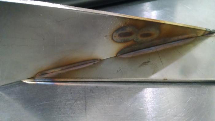

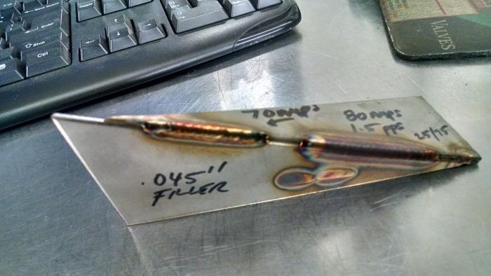

I had some 13g scrap laying around after a repair tonight so I ripped out a sample so you could see he difference.
Setting are written on the metal but 70amps 25% background, 75% peak, 1.5pps, .045" filler. I moved to nearly the front of the puddle with each pulse, no backer or purge.
I've got 16g I tacked up, I'll weld that tomorrow or Monday, no filler, no backer, no push through and post up.

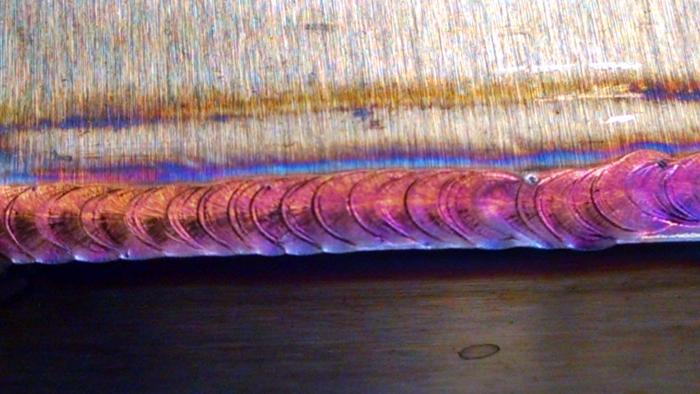

16g, 60amps, 2.5pps 50% peak, 50%background, 1/16tung, no filler. I typically would have run a little less.amps maybe 45-50 and 75% peak, 25% background but I have my Miller Maxstar 150sth out tonight and I can not adjust those settings..it has pulse but only 50%/50%
- Backside... Almost coming though, nearly 100% penetration.
