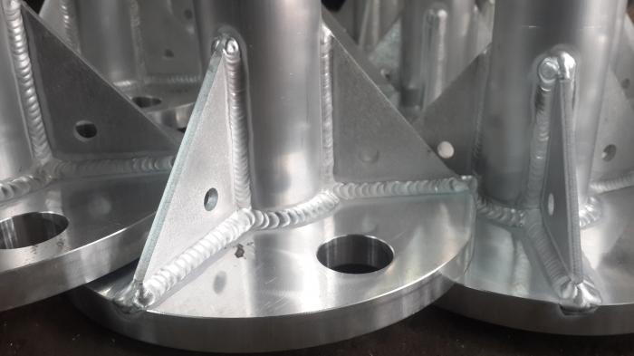

im from israel and have been welding with tig mostly stainless steel. from time to time i welded some aluminum mostly up to 3 mm. in the past months i've beed taking on more and more aluminum welding jobs.
the last job was welding 15 mm plate to 3 mm wall tubing and 5 mm suports.
im using a kemppi 2300 mls ac/dc
to max my machine capability i welded on 95% en. 50 Hz sinus wave. #5 cup with about 10 l/m or 20 cfh.
after tacking i welded the suports to the tubing first to let the metal soak heat but when i went on to weld the plate to the suports the plate was still not hot inough and the first bead was full pedal, verry slow, somewhat narrow and not as concaved as the following beads. also it had a very dull appearance compared with the others.
to those who lasted.....:)
1) is there an advice u can give on how to make all the beads shiny??? (the far bead in the pic is the first one)
2)because of the 15 mm plate i had to weld most of the way on 230 amp or i'll get llitle or no puddle, i focused the arc on the plate but my concern is the metalurgic properties of the tubbing not knowing if i dameged it or not. any advice there???
btw the gaps in the plate were designed that way which didnt make my life easy.........
thanks for the incredible patiance.
Eran

Those look pretty good. As for the shiny part of it, I would say it's not enough cleaning action. That's from my experience and my opinion. I don't do a ton of AL and unfortunately (somewhat) I don't have too many problems so I can't provide too much troubleshooting.

If you have access to a cylindet of helium to mix with your argon you will achieve a hotter arc and puddle so you can weld easier and also be able to introduce more cleaning action. Jody shows how to do this and there is plenty of discussion on the forum too. Search helium.

It sure looks like you know what you're doing. It's hard to tell from the pics but those welds are very nice and I don't think anyone would complain about a lack of shine. If that was my work, I would call it a day and walk away happy. 8-)

Looks like a pretty good job to me. Are all of the pieces made of the same alloy?

That's a good looking weld especially given the ridiculous material thickness miss-match - I'd be happy if it was me though we all want perfection! only real solutions I've seen work would be preheat the 15mm with a propane torch to start with or as others have said add helium - it really does make that much difference - I agree cost is stupidly high ( maybe due to how much Len & Steve waste ! ) I have a half size bottle & blend a bit when needed but it's tricky getting a consistent mix ratio - if you are going to do more ally work I would invest in a proper mix bottle - BUT not 75 he / 25 ar - some welders will run this but most really won't - once you get up even to 50 / 50 the arc will be hard to start & erratic when welding - if it were me I'd try to find some 25 he / 75 ar - this will usually run great on any welder - puddle seems cleaner / wets out well / mostly leaves less surface erosion - on the subject of shiny beads if your using 4043 filler & a lot of heat it always goes dull for me - if you can source an alternative that is acceptable to the client I'd try it - the new Maxal wire gets talked about here with great results but I'm not sure it's available outside the US of A - I never found any so far - best of luck with the welding - can we ask what is this part that requires such a thick base on such thin tube ? also unless it's just for looks it would probably weld easier using Mig.

thanks for the tip noddybrian. ill try 75% ar/ 25% he i hope it will work. btw i used 5356 filler wire

I have noticed that when I use certain filler wire it dulls the appearance of my beads on aluminum. They most shiny beads I get are when I have a lap joint or corner joint that does not require filler wire. But some wires are better than others as far as bead appearance. I am welding on 4043 mostly.

To me, it looks like the parts may be a bit too cold while welding. Preheating thick material before welding can help the beads shine more (and/or use a bit more amperage when welding) .The thick material may be sucking too much heat out of the weld puddle immediately after you move forward, allowing the weld bead to cool too quickly. Notice how the bead looks even duller/hazier at the start of the weld when the material is coldest:
When I weld thick material, I'll start the puddle and wait several seconds before adding filler rod and moving forward. This gives the material some time to heat up.
