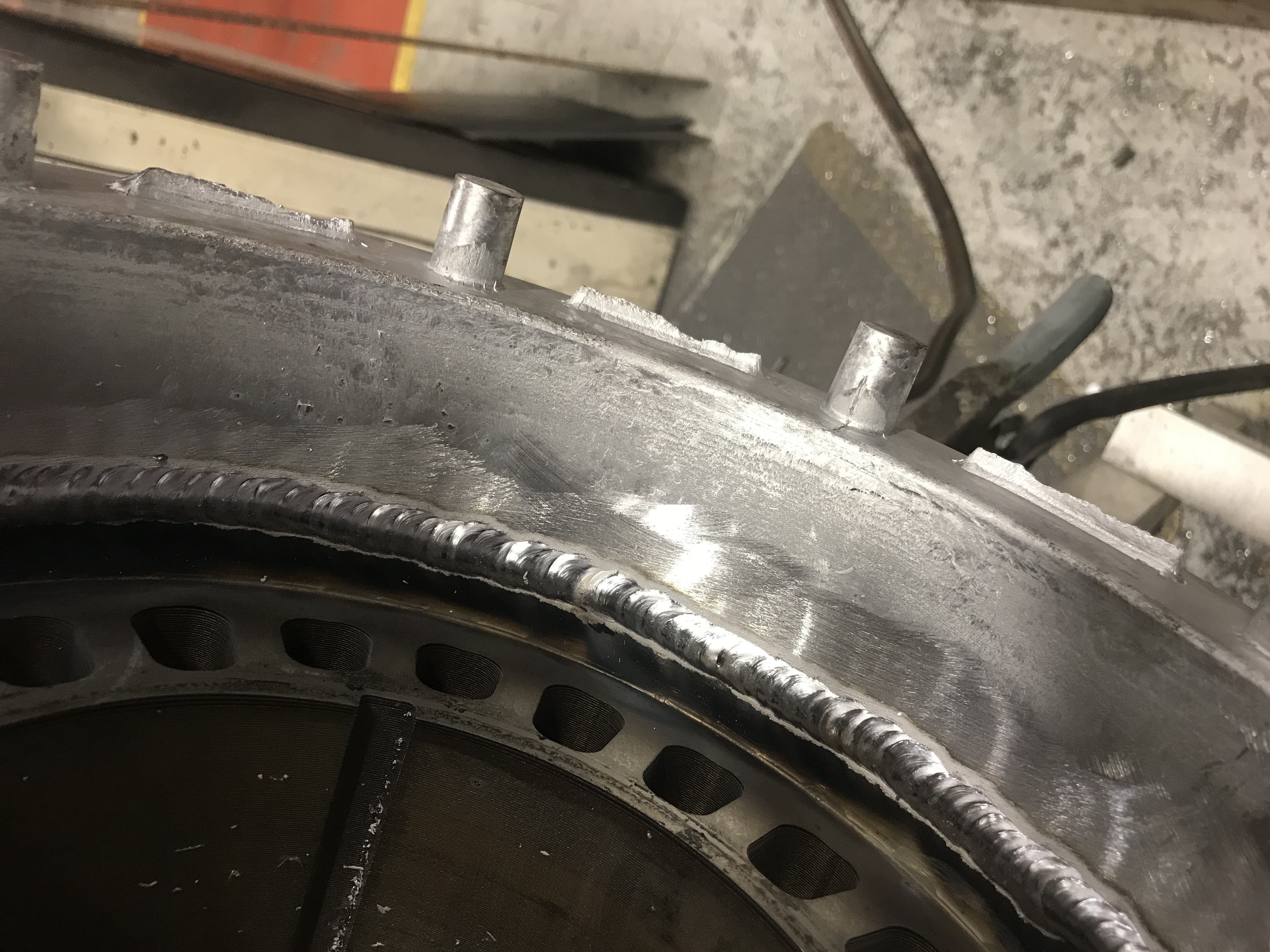

This is MIG
Course I MIGed this also
This is MIG
- Aluminum MIG core repair.JPG (2.45 MiB) Viewed 3701 times
- 30629_118440781517655_568191_n.jpg (90.25 KiB) Viewed 3701 times
- 30629_118440784850988_1920114_n.jpg (104.91 KiB) Viewed 3701 times
- 30629_118440861517647_479562_n.jpg (83.77 KiB) Viewed 3701 times
- 30629_118440851517648_2830464_n.jpg (74.82 KiB) Viewed 3701 times
