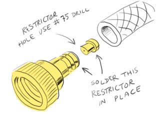

HI folks.
I have the welder listed below. It came with a flowmeter. I was wondering if the pressure is too high though.
When I start a weld there's a big gush. I don't know if it's adjustable. I could put a regulator ahead of the flowmeter I guess. I don't know if this affects my Al but my steel looks fine.
I use the same tank for a microwelder. Big gush thru a little nozzle.
I ran into exactly the same problem, went to talk with my local welding supply house tech to figure out what was going on and found the answer.
The problem is this: A flowmeter regulator works with a primary step-down diaphragm arrangement dropping the high pressure gas in the cylinder (2000 PSI) down to a stable, secondary working pressure, which in my flowmeter is something around 65 - 70 PSI.
When you adjust the valve on the flowmeter you are gating the argon gas flow. It starts at that secondary working pressure in the flowmeter, but drops down to a lower pressure after passing your adjustment needle valve on the way to the back of your welder (with it's own on-off solenoid valve).
But here's the part that's causing your problem. When you DON'T weld, the gas pressure in that section of gas tubing between your flowmeter and the back of your welder is slowly creeping up... until, yes, you guessed it, it is also at 70 PSI. So, now, when you trigger your torch, that first gust of gas coming out of your torch represents that little bit of built-up gas pressure. The longer that section of gas hose between the flowmeter and your welder, the more volume of argon gas at that higher pressure and the worse that first blast of argon out of your torch will be.
And now the answer.
What I did was purchase a second screw-on gas connector to fit the back of my welder at the gas inlet (kept the original in reserve).
Next, I turned a tiny bit of brass to fit inside the back of the that gas connector. In this tiny bit of brass is drilled a restrictor hole. That hole acts very much in the same way as the needle valve on your flowmeter, except that it isn't adjustable. I then soldered that bit of brass into the back of the gas connector, reattached the gas hose from the flowmeter and clamped it all up as normal. (see my wonky sketch, below)
The important bit is that the little bit of brass with that fine hole acts as a flow restrictor to buffer that first high-pressure rush of argon so that one doesn't get that 'gush' at the torch end.
For my purposes I used a #75 drill to make that hole. This allows me to push up to 16 CFH. Depending upon what flow you need for your welding you might want to use a slightly larger drill size. But be careful, since too large of a hole will totally defeat the purpose and eliminate the buffering effect.
Hope this helps.

- flow restrictor.jpg (36.4 KiB) Viewed 19737 times

Hey thanks for the suggestion of that orifice. I think I'll try it, albeit a bit bigger.

You would be amazed at just how small a hole will let through the correct flow of gas. So, it's probably better to 'sneak up' on the size of the hole. Start out with something on the small side (I had chosen for a #75 drill bit). If you find that you aren't getting quite the gas flow you wanted, simply chuck a slightly larger drill in a hand pin vise and drill/ream out the hole. When you are getting the right kind of gas flow start behaviour with the maximum flow you might ever use, then stop.

Yes - stop buying those retarded flow meter things that are set to insane pressures - get a decent adjustable regulator ( a twin stage oxy gauge works really well - if it bothers you you can swap the little pressure gauges over to some that say argon ) - put a floating ball on the output - adjust it to the minimum pressure needed to achieve fractionally more flow than you use - fine trim the actual flow with the needle valve - no more big surge ! there are dedicated regulators designed to achieve consistent flow without surge but they are kinda pricey for hobby use.
Thanks all! I'm gonna fix this for sure. I did a tiny fix job an noticed the surge was messing with the arc. That said, I have 20 feet of 1/4 od tube to the microwelder, and 6 feet of 1/4 I'd to the Everlast....all downstream of the flowmeter. Not good.
