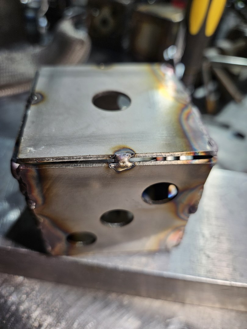

Hey Everyone,
This question is somewhat related to the original fit-up question I asked.
I've purchased several 16 ga stainless dice/cube coupon kits from Amazon. The way they are pre-cut, some of the cubes are assembled by tacking individual pieces together. Others are fit together by bending the sides into a cube and tacking.
With the individual pieces it's pretty easy to get a good tight fit at all edges.
With the ones that are bent into shape there are some pretty decent size gaps (some probably a little wider than 1/16").
With the mild steel kits it wasn't too difficult to fill the gap with 3/32" filler, although I'm sure I was overheating the base metal a little.
The 16 ga stainless is more of a challenge. I'm running 56 A, no. 12 cup, gas lense, 25 cfh Ar, about 1/2" stickout, and 1/16" SS filler.
I try to bridge the gap to start, but, it seems like half the time I chase the arc up to one edge or the other and leave a bead on that edge and a gap in between the two edges. It looks pretty ugly.
The cubes with the tight fit are looking okay, although I still need more practice.
I can cut the pieces apart and tack like with the individual pieces (or work on them with a hammer). I'm trying to get better at edge welding when fit-up isn't so good. With the stainless I'm really trying to keep from overcooking the base metal. Anyone have advice on what I might do different to work with filling the gap without overheating?

I can certainly understand if you're welding outside corners of a cube. In that case, larger diameter filler or clamping it closed to tack is probably the better option. Short of that, cutting it apart would seem the only viable choice. Those kits that have pre-bent sides and some open joints never have the correct length. So you always end up with a large gap on at least one edge
Thanks CJ,
This pic shows the gap. Even with the way the kit is made I could have take more time and at least made the gap more uniform.
And this is a pic of 16 ga with a tight fit on the corner before welding.
Even with the tight fit I know I have a long way to go to keep the heat down and be more consistent with the beads. It's a work in progress.
